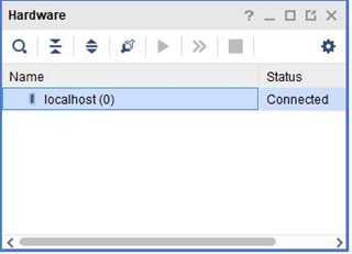

  • Hi David,
    Trying to follow the installation instruction, the HW manager didn't detect my board:
  • Hi Ram,
    Can you share the command and format of the path you used to same the Rx file? This function is tested, so we do not expect any issues to occur.
    In Vivado are you attempting to use a TI204c IP reference design? If so then to load the bit file you must connect a JTAG cable to the JTAG port, P2, on the TSW14J58EVM.
