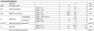

  • HI Rhea,
    Is there a specific error specification that you're looking for? Error specifications (below) are listed in the datasheet.
    If you aren't sure, this E2E article explains common ADC errors quite well. I hope that proves helpful to you!

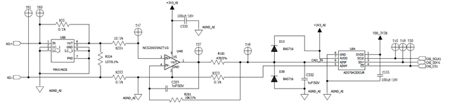

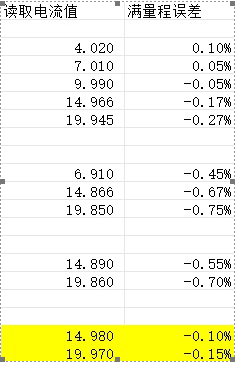

    The customer has a small part of the error in use is very large, beyond the replacement of the converter is normal. They subtract the actual conversion value from the theoretical value and divide by the maximum range. Do you have any good suggestions for this problem?
    Input 4~20ma sampling conversion, the above three errors are relatively large, the following one is normal.
    The schematic design is as follows:
    Thanks~
  • Hi Rhea,
    Can I ask what you are using to generate your 3.3V AVDD source? It could contribute to the noise since the ADS7042 uses AVDD as reference.
    Could I also know what your sampling rate is? This could help me determine if the signal has enough time to settle during acquisition.

  • Hi Joel,
    The customer sample rate is 20ms, and AVDD uses a very accurate 3.3V reference source.
    Thanks~
  • Hi Rhea,
    So with a sampling rate of 50 Hz, the signal should have plenty of time to settle before it is sampled, so I'm still unsure of where the error is coming from.
    Can you provide more information on the reference that the customer is using to generate AVDD? This will help me make calculations on whether this error is expected or not.
    Joel

    I see. With a 12-bit device, you shouldn't expect anything worse than a 0.2% error. Let's check if the error you are getting is coming from the ADC or somewhere else in the signal chain. Could you use an accurate multimeter to measure AVDD with respect to ground, AINP (T46) with respect to ground, and tell me what reading you are getting from the ADC in volts? This will be of more use than the error in current.

  • AI电源 采样电阻(Ω 输入电流 T47(测试值) T46(测试值)
    1 3.305 137.12 0
    4 0.546 0.547
    7 0.957 0.958
    10 1.367 1.368
    15 2.051 2.052
    20 2.736 2.737
    2 3.302 136.72 4 0.545 0.545
    7 0.954 0.956
    10 1.364 1.365
    15 2.046 2.047
    20 2.729 2.73
    3 3.304 136.72 4 0.545 0.545
    7 0.954 0.955
    10 1.364 1.364
    15 2.045 2.045
    20 2.727 2.726
    您好,乔尔。
    编号1的误差范围相对小一些,编号2、3就较大一些。采样电阻上是有差异性,把编号1的采样电阻放到编号2和3的板子上,误差有所改善,但还是在0.5%以上。编号2更换一个AD转换器,误差就会好很多,把2号的AD转换器换到1号板子上,误差就又差很多。
