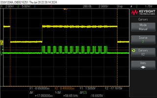

We are experiencing an issue with the transmission of the 24-bit clock in our controller. The current setup introduces a delay after every 8 clock pulses. Specifically, there is a delay between each group of 8 clock pulses.
Given this mode of clock transmission, we are uncertain if the data will be received correctly. Could you please advise if this transmission method is acceptable, or if adjustments are necessary to ensure accurate data reception?
Additionally, could you please advise which mode is better for data reception: continuous 24 clock pulses mode or the current mode with a delay between every 8 clock pulses?

Hello Aravind,
It is acceptable to have delays between groups of 8 clocks, and will not impact device performance as long as all data can be read out of the device before the next conversion result is ready (next /DRDY high to low transition).
