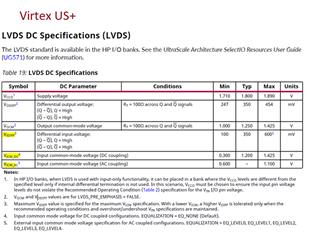

I need confirmation related to ADC12D1800 will support Virtex ultra scale + FPGA(XCVU23P-J1760) for Differential signals as below specifications and voltage ranges for both
ADC Spec
Thanks & Regards
