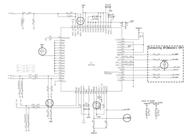

Hi TI engineers,
We have problem when using BIAS to measure ADC value,
We're measuring by channel 1.
The issues is after I read data, seem it is verry small changes for each sample.
( This is some samples I combine from 3 bytes channel 1 to int:
 729037
 728863
 729045
 729435
 729399
 729124
 728936
 729191
 729582
 729466
 729112

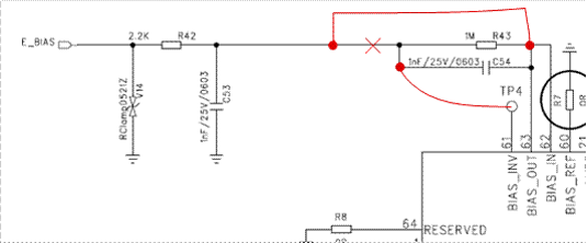

- This is our hardware design

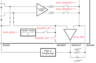

    The BIAS measurement will compare the voltage connected to the BIASIN pin to the selected BIASREF voltage as shown in Figure 38 in the data sheet (see below). In your configuration, you are using an external BIASREF voltage, which is connected to GND. I assume that you are using ±2.5V analog supplies and GND is your mid-supply reference?

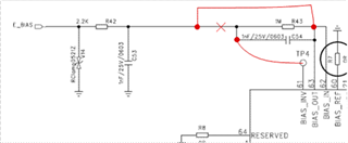

    However, the BIAS amplifier circuit in your schematic is missing the feedback connection between BIASOUT and BIASINV (BIAS amplifier inverting input). The amplifier is operating in an open-loop configuration, so the output voltage at BIASOUT may be floating to approximately 30 mV. 30mV x 12V/V would result in the output codes you are observing.
    Please correct the BIAS circuit according to the markups below:
    Ryan

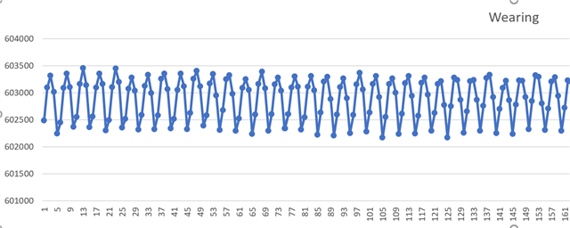

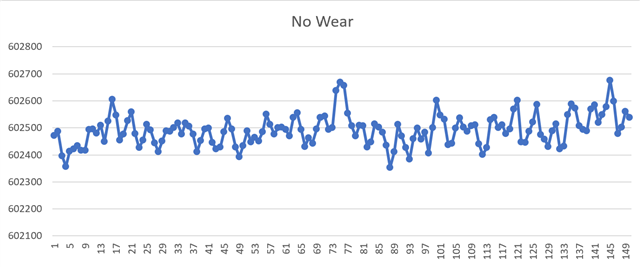

  • Hi Ryan,
    After we changing hardware as you suggest, this is the result.
    (We're doing EEG applications, the resut includes two cases: when I no-wear device to the head, and when wearing device to the head)
    - When no-wear
    - When wearing
    You can see, the results changed when I start wearing device to the head. But I don't know the signal is normally. I see that the waveform is chaging, but the Voltage amptitude seem does not change to much.
    Please help us check this result.
    Best reagards,
    Toan
  • Hello Toan,
    The sinusoidal waveform you are observing in the second image is simply 50 Hz power line interference. This type of noise is common in bio-potential applications. The common-mode rejection of the system (ADS1299 + Bias electrode) can help to reduce the peak-to-peak amplitude of the 50-Hz noise, but any remaining noise is usually removed using some type of digital filtering (i.e. notch filter).
    The actual EEG waveforms exist in different frequency ranges. We are not the experts when it comes to identifying proper EEG waveforms.
    Can you share the complete ADS1299 register configuration used for these measurements?
    Ryan

  • Hi Toan,
    Thanks for sharing. As mentioned in my previous post, it's likely that your electrodes and lead wires are picking up power line interference. This is being sensed by the BIAS derivation circuit (BIAS_SENSP/N = 0x01) and driven to the BIAS amplifier output. You are measuring noise through CH1; however, in the real application, this signal would be driven back to the body and help to suppress the common-mode noise at the source.
    The setup and register settings seem correct. What is your next step in the prototype evaluation?
    Ryan

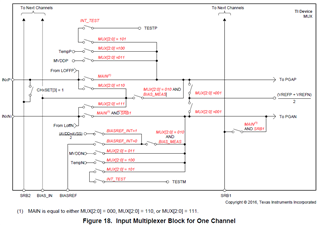

  • Hello Toan,
    When the channel MUX setting is configured for bias measurement, the input switches to INP and INN are open. Please refer to Figure 18:
    Ryan

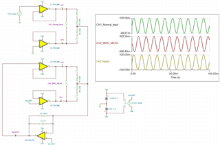

  • Hello Toan,
    The test I suggested allows you to measure the sine wave through CH1 (normal input path) and CH2 (internal BIAS measurement) at the same time. CH2 register settings are configured to measure BIASIN - BIASREF (PGA2P = BIASIN, PGA2N = BIASREF).
    Please find the TINA simulation below. I hope this helps to explain the register configuration I suggested in my previous post. You can see how Normal Input and BIAS_MEAS channels are configured:
    ADS1299_BIAS_MEAS.TSC
    Ryan

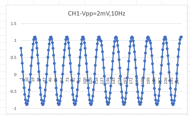

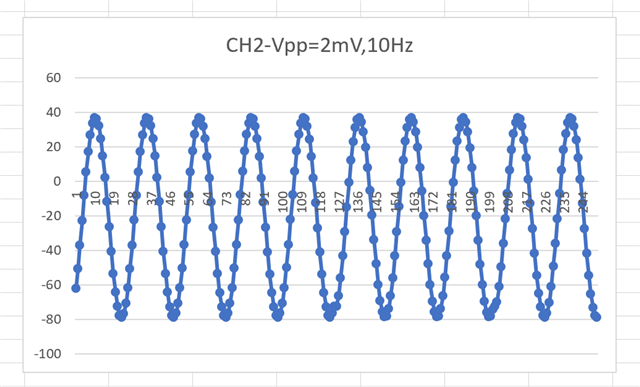

  • Hi Ryan,
    After follow your setup measure both CH1 and CH2, I can see the waveform of CH1 same with CH2
    Note (I change CH2SET = 0x02 to 0x62 for gain)
    This is the results:
    CH1
    CH2:
    This is the registers:

    Is my measure result correct with the config registers.
    Toan
  • Hi Toan - yes, the results look as expected. Feel free to begin a new thread if you need future assistance.
