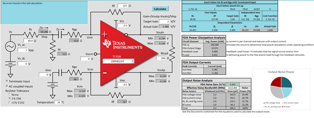

We have a legacy system with ADC12D1800 whose VINI+/- and VINQ+/- were connected from LMH6554WNC as below.
Now that we are migrating to ADC12DL2500, can the same circuit be used? or should any components in this circuit be tuned?
The input to LMH is from a Digital step attenuator.
