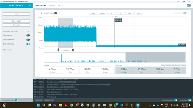

    You are right. In the previous measurement, I used a board with 4 ADS and some components that drained 52mA. Now, I have set up another test with a board including one ADS1299 and a few regulators (+2.5V, -2.5V, 3.3V, and -3.7V). The new measurement confirms the values mentioned by you and the datasheet, totaling about 9.3mA for the whole board. I used the Nordic Power Profiler Kit (PPK2) and noted that the VDD is 3.3V.
    Re: Start Pin High/Low
    I did exactly what you suggested. I configured the ADS for continuous conversion, started recording by sending the RDATAC command, and set the START pin high. After 4 seconds, I set the START pin low. There was no change in the current. Then, I manually set the START pin high and low using a jumper wire—still no change. I also tried sending the START/STOP conversion command and using both command and GPIO methods. None of these methods changed the current consumption. Finally, I sent the STANDBY command after 4 seconds of conversion start, and the current dropped from 9.3mA to 1.2mA (see attached). But, I want to save power by single-shot mode, not Standby/wakeup.
    I hope this information helps. I am happy to do more test to solve this issue.
    Saeed
  • Hello Saeed,
    Thank you for the update. Based on the results you shared, I believe this confirms that the overall power consumption during normal operation is dominated by other internal circuitry, such as the internal bandgap voltage (used for the ADC reference voltage), reference and BIAS amplifiers, etc. The ADS1299 does not scale power proportionally to its data rate as drastically as a SAR ADC. This remains true whether the device is converting continuously or on-demand. The power can only be reduced further by placing the device into Standby mode.
