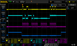

Hi all,
I am trying to work with an ADS1298 board I inherited by first trying to read the ID of the board before trying to read ECG data. Since it's an ADS1298, I'm expecting the message 0x92, but I am not reading any data on the DOUT line (MISO). I checked the FAQ section for this chip and nothing really helped. I followed the power up sequence guide and VCAP1 seems to be above 1.1V at around 1.3V, so something must go wrong after this step.
I am using a NUCLEO STM32F767ZI for communicating with the ADS chip. In the screenshot below you can see the two functions I used to power up the chip and initialize it for reading the ID. The first one is running only once, and the second one is running continuously.

 These are the SPI settings (SCLK is at 3 MHz):

Some relevant info that cannot be seen in the screenshot I took on the oscilloscope: the DRDY pin is stuck high. I am using a custom GPIO pin for CS, will report back later if I'm facing the same issue with the NSS pin for SPI1. I have also seen some people setting up the DRDY pin as an interrupt, will also do that and report later, but I doubt this is the main problem since I am not reading anything on the MISO line.
Below you can see a screenshot from the oscilloscope of the SPI communication. From top to bottom, the lines are MISO, MOSI, CLK and CS. Any help would be greatly appreciated!

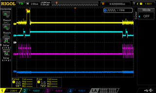

  • Update: I am reading the ID correctly now (0x92 on the yellow MISO line) because the 2.048 MHz external oscillator wasn't connected to the CLK pin, but I am getting some crosstalk between the MISO and MOSI lines. I am working on optimizing the code because the HAL functions apparently have large delays as you can see.
    Any suggestions that would help fixing the crosstalk would also be greatly appreciated!
  • Hi Bogdan-Mihail,
    Thank you for your post.
    Cross-talk can be reduced using clean layout techniques. As you can see, there is quite a bit of overshoot on the SPI signals, especially SCLK. A smaller series resistor (i.e. 10-33 Ω) can help to reduce the overshoot and consequent coupling.
    Ryan

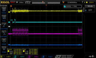

  • Hi Ryan,
    Thanks for replying to my post. I will implement that a bit later as I don't have low value fixed resistors at the moment. Right now I am facing another issue.
    When I read the ID, I am also getting the CONFIG1 register which is the register right after the ID 0x92, even though I set the RREG command to {0x20 | 0x00, 0x00}, indicating that I only want to read one byte. Also when I want to print out the ID value, I am reading CONFIG1 0x86 instead of 0x92.
    Do you have any suggestions on how to get rid of the extra byte? I thought I was flushing the FIFO by reading the buffer after each byte that was sent.

  • Hello Bogdan-Mihail,
    You can ignore the first byte of data which comes out on DOUT while you are sending the SDATAC command (0x11). The contents of the output shift register will vary depending on the data sent in the previous frame. Perhaps you can send SDATAC in a frame by itself, followed by a separate frame for the RREG command.
    Ryan
