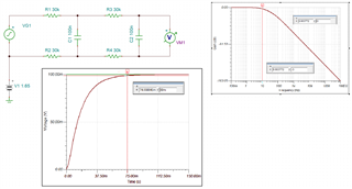

    Your input circuitry has a super low cutoff frequency, at around 10Hz. This is going to take too long to settle every time you switch inputs. The settling time to ~99% is around 75ms.
    You should increase the filter cutoff frequency by reducing the size of the resistors and capacitors.
    I mentioned this in the other post that you referenced, from your colleague Prashant
