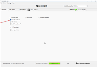

I am using the ADC3000 GUI in order to program the ADC34J23 and the LMK04828 on the ADC34J23EVM. However, changing any setting in the GUI or loading any config file using "Low Level View -> Load Config" has no effect on the hardware: neither the LMK04828 chip nor the ADC. The strange thing is that the GUI window shows "Operation successful" when a config file is loaded, but the LED D4 does not switch on, nor does the change in setting take effect (verified by measuring the clock output using an oscilloscope).
I have verified the hardware jumper settings:
The current consumption of the EVM stays constant throughout with 468 mA at 5V DC.
Could you help me debug what could be holding the chips back from being programmed?
