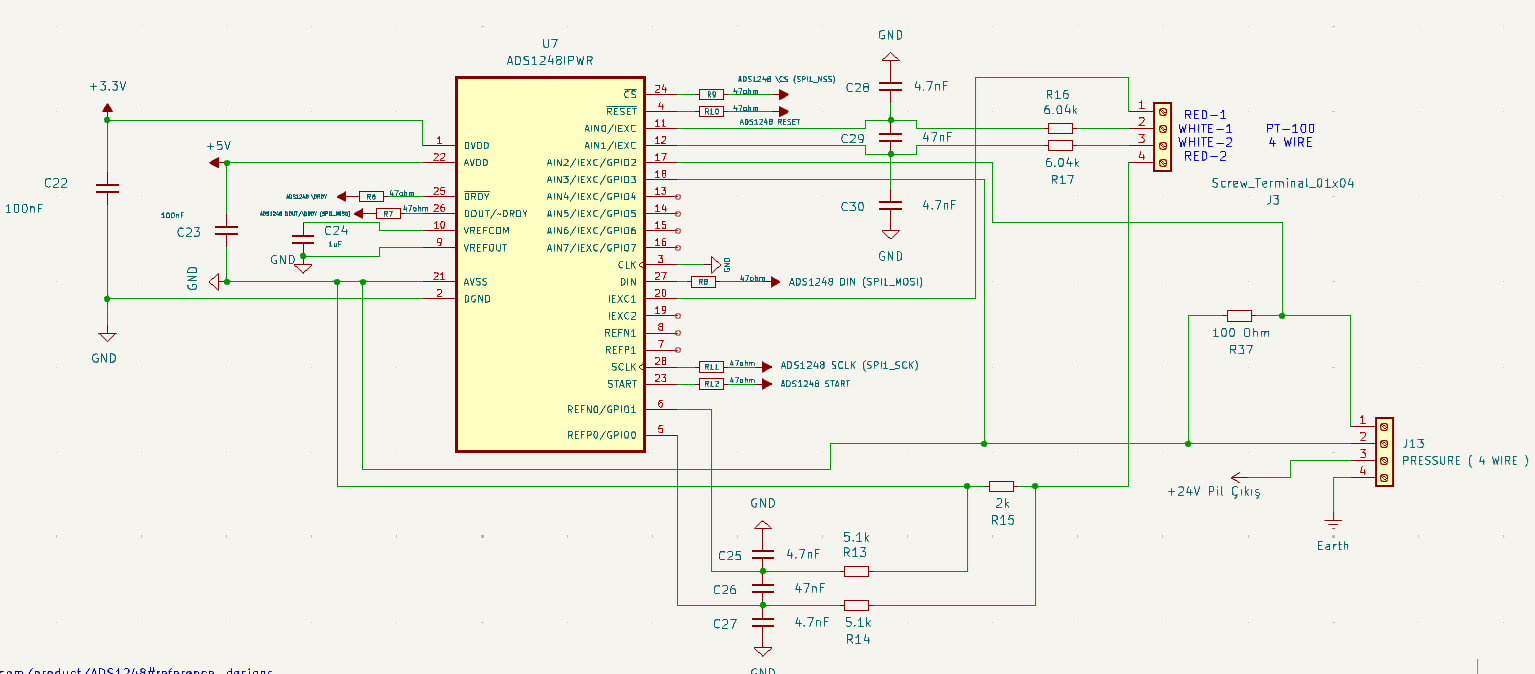

Hello
We want to make a connection between the ADS1248IPWR product and the PT100 and PRESSURE TRANSMITTER( 4-20mA). Our drawing is below. We are not sure about this drawing. We think there are some deficiencies. Could you help us?
Thanks.
Michael
