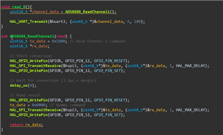

Hey, I have got a problem with the readings from the ADS8688A, I am using the STM32h7 controler, it is all routed as rescribed in the datasheet, but when i try to read the value on any of the channels i get FF (full- scale) but the pins are not connected to any thing, and when I send the "Set range" command it does not react ot the command.
