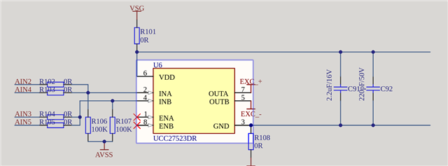

We are currently experimenting a strange issue with the 2 wire excitation  mode. Our schematics, is exactly the same as the one in the EVM (with the exception that we use the UCC27523DR)
The custom pcb is for a 6 axis load cell, and the acquisistion is roughly like this:

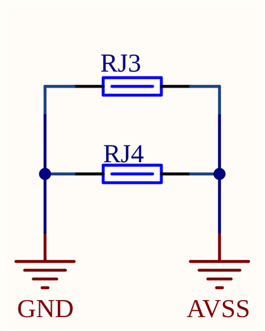

    Yes, find attached a simplified schematics of our board:
    ADS1261 Report.pdf
    Moreover, I do not know how, but it seems that after using the ACX mode in this way, the ADS seems to not be responding anymore to the SPI command: can it be that it has been damaged by an high voltage outside its operating condition?
    Thank you very much for your help,
    Elia

    None of the supply nets have voltages, they just say e.g AVDD, AVSS, etc. Can you provide the ADC supply voltage levels as well as the excitation voltage levels (VSG+, VSG-)?

    Yes you are right sorry. I cannot show you the power input stage, but:
    • AVDD: 5 V
    • AVSS: GND
    • DVDD: 3.3V
    • VSG+ / VSG- comes out from a switch and go directly for "powering" the load cell (as you can see in "Input Stage / Load cell"). When using the 2 wire ac mode, we switch it manually to EXC+ / EXC-

    When using the 2 wire excitation mode, we switch the switch S1B, so that VSG+/VSG- is equal to EXC+/EXC-. The output of this are shown in the figure above. So, we are basically exciting our load cell with a differential voltage of VSG+ = 5 / VSG- = -5, because the difference of (VSG+ - VSG-) is given by a difference of a (square wave - (-1*square wave)), as you can see in the figure above. This is where my concern lives: given the fact that the load cell is basically (in simple term) a resistor, we are giving as analog input a voltage that is below AVSS, when the excitation voltage is -5V. Am I missing some points on how 2 wire excitation works?
    Why do you have AVSS and GND nets if they are the same potential? How are these connected on the PCB?
    They are connected together through a net tie, so they are at the same potential.
    Elia

    The applied voltage is not negative with respect to ground during AC excitation, it just has the opposite polarity. So you are applying 5V to the top of the bridge and 0V to the bottom of the bridge during the first phase, and then you are applying 5V to the bottom of the bridge and 0V to the top of the bridge during the second phase. So this should not be an issue. But when you mentioned "high voltage" it wasn't clear to me what the excitation voltage actually was
    Have you tried slowing down the ADC? My originally thought is that you are seeing settling issues because the excitation polarity is switching so fast. The RC circuit you have on the ADC inputs needs to settle every time the excitation voltage switches, and 40kSPS might be too fast
