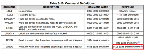

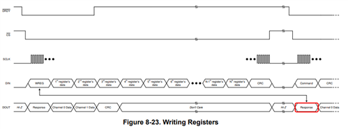

    I have one question or suggestion for you, did you send one more frame to the ADC after you sent the WREG command in the step 6? If so, you should be able to see the following response for your WREG command from the ADC. The response should shown on the first word in the next frame as you can see the timing below.

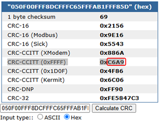

    In the timing, the frame includes STATUS word + CH0 data + CH1 data + CH2 data + CH4 data + CRC word in 24-bit word length.
    The CRC checksum from the B04 ADC in this timing is 0xC6A9, this is the correct checksum for the data '050F00FFF8DCFFFC65FFFAB1FFF85D', see the screenshot below (this was checked with one of the free online tool: https://www.lammertbies.nl/comm/info/crc-calculation):
    Please note the CRC calculation on the ADS131B0x-Q1 is initialized with the seed value of 0xFFFF.
