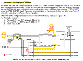

Clock setting is External mode(default).

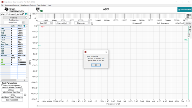

Q1

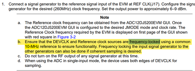

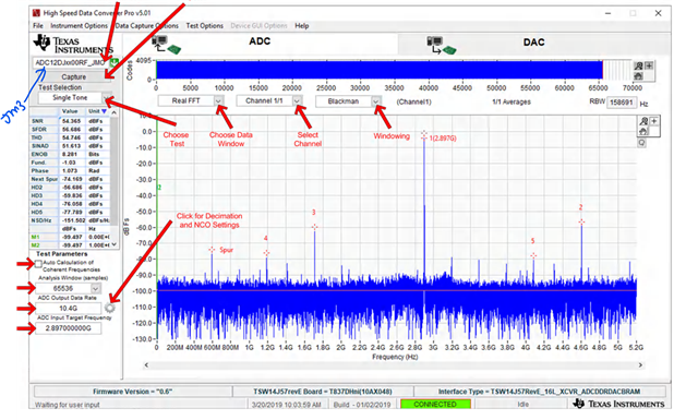

When click the Capture botton, show following and doesn't show waveform on HSDC pro GUI.
Do you know the reason why this message show?
Read DDR to file CAPTURE_FLAG_NOT_SET Capture done bit not set

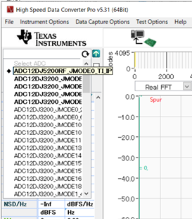

Q2

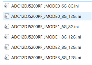

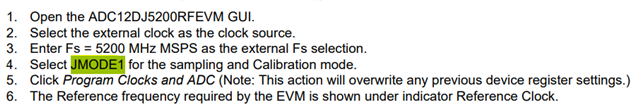

Is it correct to select "JMODE0" for ADC on HSDC pro GUI?
There is not JMODE1 on the list of GUI.
