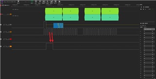

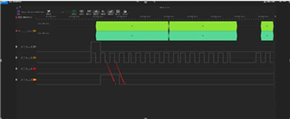

ADS8361 data bit shift,could u give some suggestion;
The following is the waveform diagram of the test, and the data in the ID bit is clearly incorrect.
It's wrong wave form
Correct waveform
Wrong bus waveform
Correct bus waveform

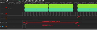

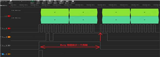

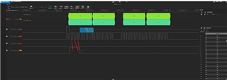

  • Dear Yolanda
    Below waveform is good enough?
    The above is the same set of data. The normal data bit CH1 CHB is 1 1, but the abnormal data bit CH1 CHB is 1 0
