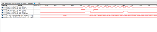

Behavior:
  • When I connect AVDD to AIN2, I get expected results (e.g., 0xFFF).
  • When I connect other voltages (e.g., 1.2 V, 2.0 V) or leave AIN2 floating, I receive random values such as: 0x820, 0xC08, 0x408, 0x402, 0x000
  • SignalTap waveform shows:
    • sdo transitions correctly on falling edge
    • sdi is not stable for a full SCK period — it appears to change mid-bit
    • MISO values look corrupted even though CS, clock, and timing all match datasheet spec

  • Hi Sameer,
    Sorry to get to this late. I was out of office for the majority of the past week.
    You shouldn't have any issues running the interface at a full 60MHz, in SPI Mode 0. I am able to operate at maximum speeds with no issue from the device without an issue.
    The confusing part on my end was that SDI and SDO on your logic captures is labelled in reference to the controller, so from the device, they are flipped. It would be useful to have one labelled as MOSI and MISO.
    I'm not sure why the device's SDO would not stay high the entire SCLK cycle. That is not something I have observed before. If you probe the lines with an oscilloscope, do you see the same behavior?
    There could be signal integrity issues. I would first start by testing the same sequence at slower clock frequencies. Another thing to consider is how long ~CS is held high between conversions. What is this period? At a minimum it should be 600ns.
    Joel

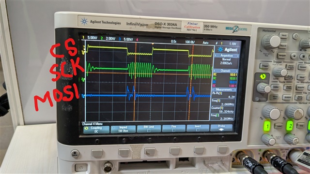

  • Hi Sameer,
    Thanks for the info. This current implementation seems likely to be causing issues, especially at high clock frequencies. Once it is all integrated on a PCB, I would expect these issues to go away, as SPI is actually not especially demanding in terms of maintaining signal integrity.
    Are you able to send oscilloscope captures instead then, making sure that the ground probe is as short as possible to reduce external noise pickup, and at least for SCLK, using ground spring probe? The SDO behavior from the device does not seem normal, so I'm wondering if there are some false SCLK edges being picked up.
    You should be able to send 13 SCLKs and still get data as expected. I think you are viewing it from the perspective of what is sent from the FPGA, but from the device perspective, it will send ADC conversion data on SDI as long as a register read command hasn't been sent in the previous frame.
    Is the sampling rate on the logic analyzer configurable? If so, what speed are the digital signals sampled at?
    Joel

  • Hi  ,
    I am attaching my oscilloscope results, below. Please fine the attachment. Please try to compile my verilog code any EDA tool and try to test with your set up, if possible. Then it will be helpful to me. I didn't receive any mail to connect with you in. Can you please specify which platform you send me the link.
  • Hi Sameer,
    Yes, the SPI lines look very noisy. Might you try probing with ground spring probe attached and seeing if you get better results?
    I sent it via E2E. You should see it by checking your notifications or under the friends tab. We can connect privately afterwards.
    Joel
