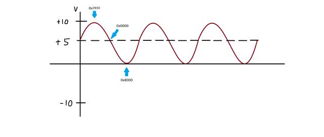

    From the standpoint of the ADC code output, 0x7FFF is full-scale positive.  Full-scale negative would be 0x8000 and the mid-scale code would be 0xFFFF or 0x0000.  How are the grounds connected between your DAC and the ADC?
  • Hi Tom,
    The DAC and the ADC's GND is connected to a common point, which is my MCU board's GND pin. Additionally, the external power supply's GND is also connected to the same common point. For the Analog Inputs, Channels 2-8 are connected to the common point GND, with only Channel 1 being connected to the DAC's output.
    As for the ADC output, does that mean that anything above 0x8000 is negative (in this scenario is above 5V) and anything below 0x7FFF is positive (below 5V)? I would assume that it would be the other way around.
    This is what I assume to be the expected values acquired:
    Instead, at 0V the ADC captures 0x0000.
  • Take a look at Figure 66 and Table 2.  If you are in the +/-10V range, your 0-10V DAC should give you 0x0000 to 0x7FFF.  One code below 0V is 0xFFFF and at -10V you would have 0x8000.

    No, that should not matter.  From your picture though, at 0V that code should be 0x0000 (not 0x8000) and the dashed line at 5V, that code should be ~0x3FFF (not 0x0000).
