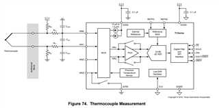

Hi  Sir
pls help to check the schmetic ,many thanks!
  • Hi Gabriel,
    Looking at your schematic it looks like you are using 2 external MUX's to switch through 8 total thermocouples with the general set-up following Figure 74 in the ADS1220 datasheet.
    The only note I would add would be regarding the thermocouple biasing resistors and antialiasing filters. Typical values for the biasing resistors range from 1 MΩ to 10 MΩ. Although the device digital filter attenuates high-frequency components of noise, TI recommends providing a first-order, passive RC filter at the inputs to further improve performance. The filter component values used in the diagram above are: RF1 = RF2 = 1 kΩ, CDIF = 100 nF, and CCM1 = CCM2 = 10 nF.
    Overall, the schematic looks to follow the recommended application for the thermocouple measurement and should preform as expected.
    How do you plan to measure the cold junction temperature of the thermocouples?
