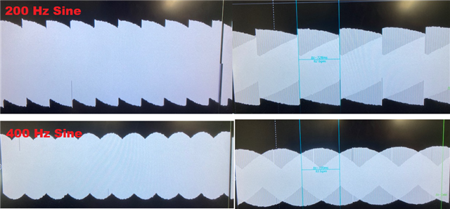

We are currently designing a system using the ADS1291 for an ECG application. During testing, we used a RIGOL DG1032 waveform generator to produce a sine wave signal (5 mV, 0.5 Hz – 500 Hz).
We observed that at higher frequencies (above 200 Hz), the sine wave begins to exhibit an amplitude modulation effect, resembling an envelope distortion coupled by a low-frequency signal around 1.4 Hz to 1.5 Hz, as shown in the image below.
Could you please advise what might be causing this envelope-like distortion?
We suspect it may be related to the waveform generator or an interaction with the ADS1291 input configuration, but would appreciate your insight.
Thank you for your support!
BR
Joe

    What is the sampling rate of the ADS1291? Can you share the register configuration Address || Data?
    Ryan

    We’ve set the PGA gain to 4 and configured the sampling rate to 2 kSPS. The corresponding configuration files are attached for your reference.
    We’ve also probed the signal directly at the input stage and confirmed that there is no amplitude modulation present at that point, effectively ruling out issues with the waveform generator or hardware front-end design.
    Additionally, we experimented with adjusting the C filter (originally 4.7 nF) between PGA1N and PGA1P to see if the issue might be due to higher-frequency aliasing folding into lower frequencies. However, changing the capacitor value didn’t help resolve the distortion.
    We are now considering whether the Sinc-3 digital filter might be contributing to this behavior. According to the datasheet, a 500 Hz sine wave input should only experience around -3 dB attenuation, so theoretically it shouldn't be causing this issue.
    Do you have any insights on this? Would increasing the sampling rate to 4 kSPS or 8 kSPS potentially help in our use case?
    Thank you!
    Joe
