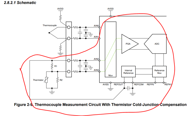

    A typical thermistor measurement would be designed using the REFOUT of the ADS124S08 to bias the thermistor, this is called as voltage excitation, then measure across the thermistor as shown in the circuit that is circled below. In this case, the REFOUT from ADS124S08 is used to bias the resistor divider, and the ADC measures either the top (differential) or bottom (single-ended) resistor. You would then use the ADC's internal VREF as the measurement reference. This will be a ratiometric measurement, since the thermistor output voltage will scale with the ADC reference voltage. This is important as measurement excludes the drift of the excitation source. The VREF on the ADS124S08 can be driven up to 10mA, so it should be more than sufficient to bias multiple resistor dividers/thermistors.
    It is also possible to use an current excitation, but the current generally needed is pretty low (~10uA) because the NTC resistance can be very high (nominally maybe 10k, and then can increase to 100kohm at the temperature extremes), so the voltage-excited circuit as explained above is more common.

    The multiplexer switches usually have an on resistance from tens to hundreds of ohms. The IDAC inside the ADC is routed through the multiplexer switches, then you have to live with that additional voltage drop because of the resistance on the multiplexer switches. This is not a specific concern, it will just lead to an error because of the voltage difference like the customer mentioned in the previous post.
    I understood the limit you have to use the current excitation instead of the voltage excitation in your design, your circuit worked well probably because the voltage drop is small and neglectful to your accuracy requirement. If the impact is obvious in your other design in the future, you may do a calibration to calibrate out the voltage difference in your software, or use a dedicated analog input pin as the IDAC out to externally route the current to the appropriate thermistors (this is the best solution).
