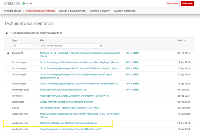

  • Hello Pieter,
    No need to apologize, I just wanted to make sure I understood. Thank you for explaining again.  Also, I do apologize that the link did not work, I have added it again:
    ADS8528, ADS8548, and ADS8568 Timing Considerations
    In case it does not work again, it can be found in the ADS8568 product page, under Technical Documentation
    That application note highlights some vital timing that is necessary to achieve the fastest throughput. What it comes down to is having a controller that can provide an external clock and that it is synchronized to the CONVST in the nano seconds range.
    A critical timing with this device is the alignment of the conversion clock and the CONVST signals to ensure that the device takes 19 clock cycles to convert instead of 20. Then having the minimum delay possible to start reading the output data.
    From the document it does seem like the Cx000 family could be used to get to or close to the maximum throughput. They might not have an explicit QSPI functionality, but configuring for a QSPI could be possible with some additional configuration, like you mentioned. I believe this E2E thread was eluding to something related to this functionality.

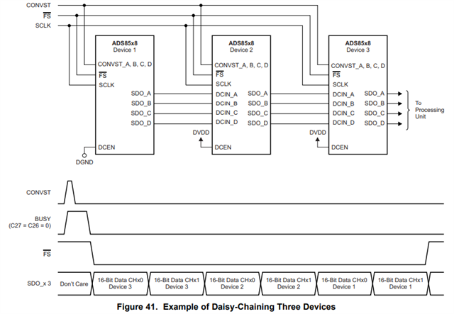

  • Hi  ,
    Apologies, I have a quick follow up question which I didn't think about until now.
    As the max sampling rate of the ads8568 is 400ksps, I assumed that if I daisy chained 3 then the sampling rate would decrease to 400/3 = ~133 ksps.
    Given that the ADS8568 sclk input can operate at a frequency of 45 MHz would it then be possible to have 3 ADCs daisy chained running at ~400 ksps?
    Given a sclk requirement of  (16 bits x 24 channels x 400 000 samples) / 4 data lines = ~38.4 MHz (ignoring conversion time, etc).
  • Hello Pieter,
    No need to apologize, that's what we are here for!
    400ksps would be the max sample rate when reading from only 1 device, so when reading from 3 devices the sampling speed will decrease.
    Similar to Figure 41 in the datasheet, with 3 devices in daisy chain, using all 4 SDOs, it would take 32 SCLKs per SDO per device in daisy chain to get all 24 channel data, that plus the time to convert, lets use 1.7us since its the max spec (this could be decreased a bit if polling the busy signal), plus the las tFSCV
    Meaning t_sample ~= t_conv + (32*SCLK*Daisy-Chain Devices) + tFSCV
    --> t_sample = 1.7us + (32*22.22ns*3) + 40ns =~ 3.87us --> 258ksps
