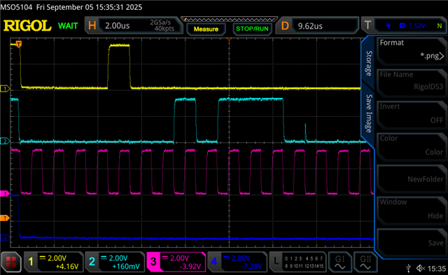

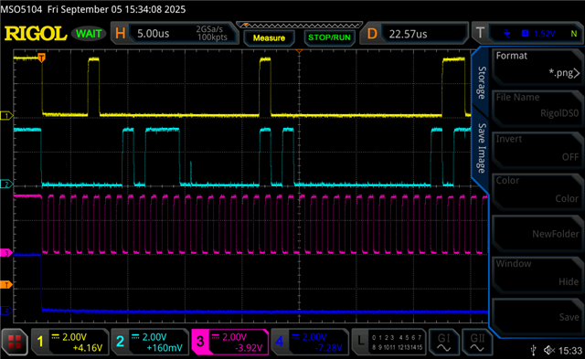

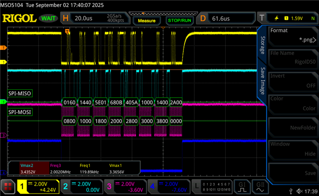

I think I'm experiencing same issue to related question.
I think that everything is set correctly to retrive data in continuos mode. fSCLK set to 2 MHz, SPI mode 3.
But the data from channel 1 to 7 are never the same even if I put the some resistor (with different value) on input channels.
I'm using ADC128102EVM connected to Microchip SAMRH71 microcontroller.
Do you have any suggestion to understand if there is some SPI configuration error?
Thanks and regards,
Enrico
Yellow: MISO
Light Blue: MOSI
Purple: CLK
Blue: CS

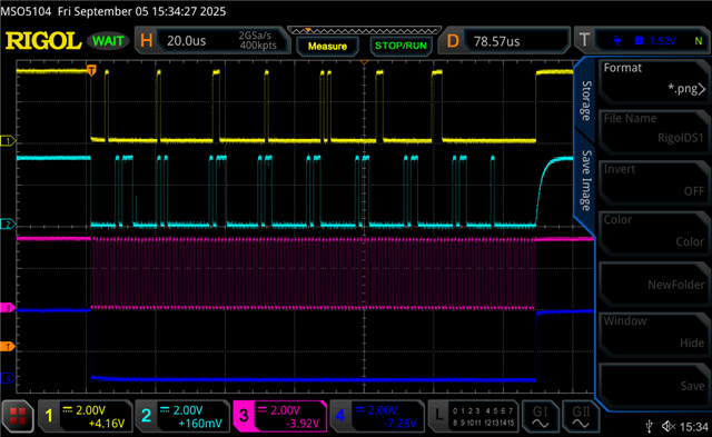

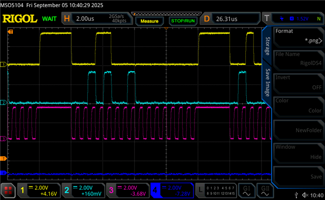

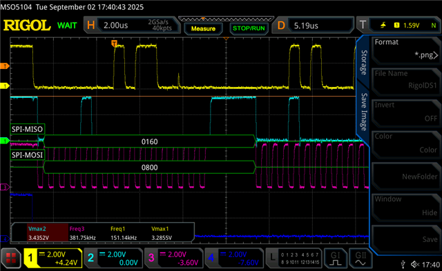

  • Hi Joel,

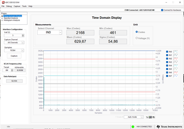

    I try the TI GUI and I see that everything is working as expected. (See below the order of signal are MOSI, MISO, CLK, CS)

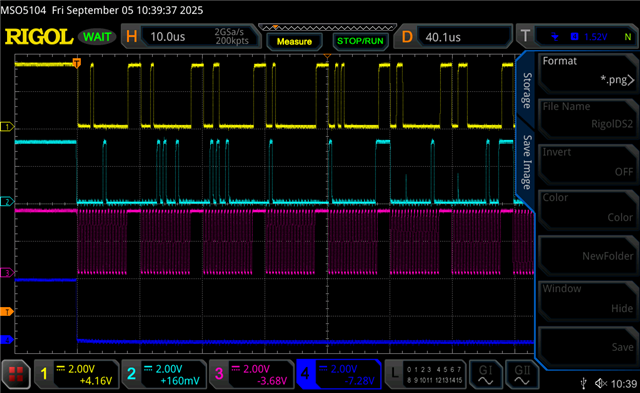

    Then I try my setup, see image below.
    The procedure that I'd like to do is to acquire all channel with a single SPI communication (continuos mode).  The SPI output buffer is charged with channel1-channel7 address + channel 0 address to get channel 7 measure. The set up is providing 3,3V to the EVM.
    What I'm experiencing is that the channels never respond with same values and not in range. Also never see leading 0 in response.
    It seems also that the channel 0 respond different value respect the ones received with GUI. (0x170/0x180 VS 0x1D1/0x1C7)
    The main difference I can see is that the clock has a period of stuck, not sure why at this moment. I manage SPI comm with interrupt to update output buffer. Is this the issue in your opinion?
    I'm also going at lower frequency (2MHz)

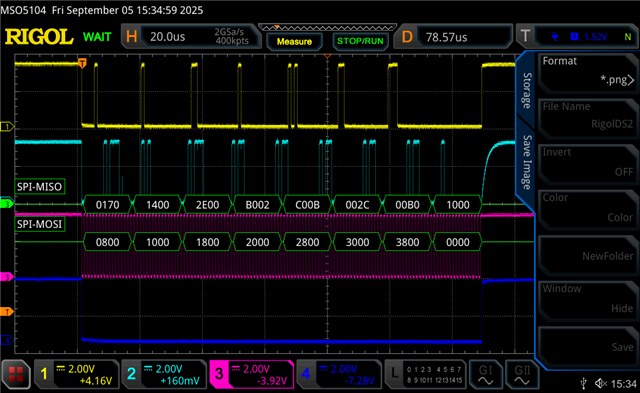

    All channels:
    Channel 0 response
    Channel 1 response
    Thanks and regards

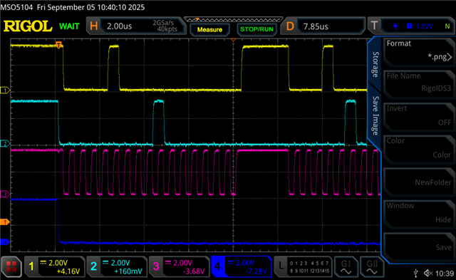

  • Small update from my side:
    I've removed the space between two transmission even if the frequency now is 1MHz.
    Same results Disappointed
    I hope you can see a misconfiguration that I can't see.
    Thanks and regards

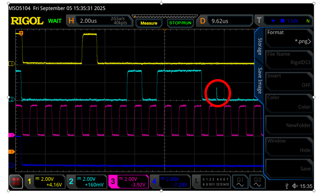

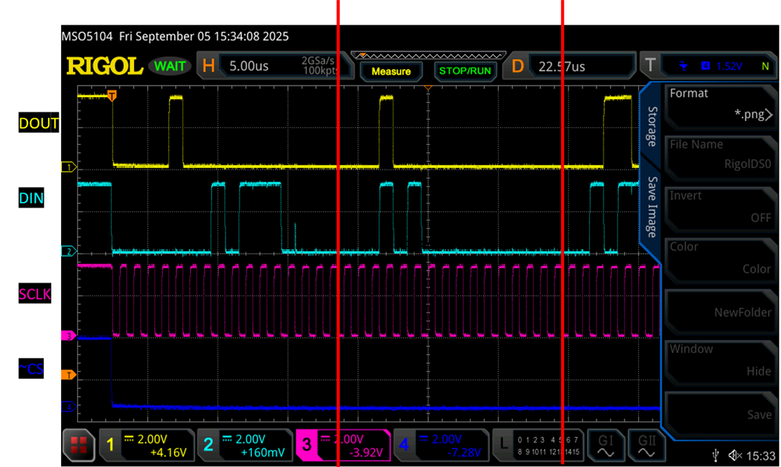

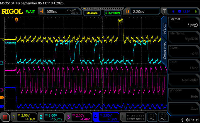

  • Hi Enrico,
    Thanks for sharing these captures. I went ahead and marked up the image showing the problem just to make it easier to see. Red lines demark the end of a SPI frame. It seems like data is coming one bit earlier than we would expect from the datasheet description,
    What is the data being sent on DIN? It doesn't seem to be aligned with where the ADD[2:0] bits should be issued on the 3rd, 4th, and 5th clock.
    One thing you may be able to try is tying to input to AVDD, so as to make to output 0xFFF. Then, the four zeros might be more clearly seen.
    There is also interesting behavior on DIN, in a slight transition on the 14th falling edge. Any insight on what the controller might be trying to do at this point?
    Joel

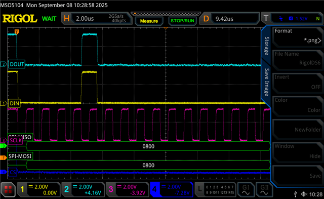

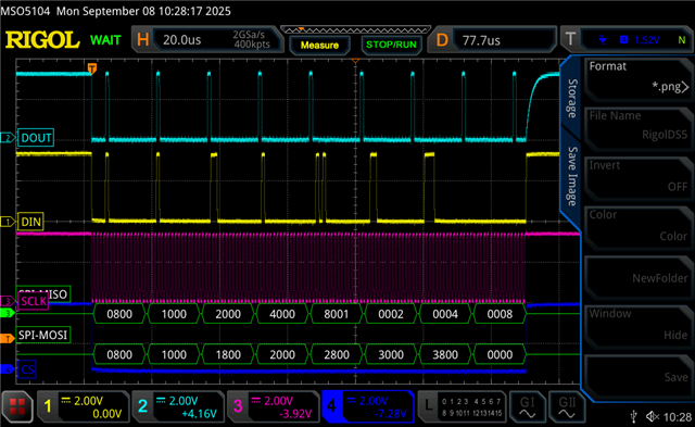

  • Hi Joel,
    I think I've made confusion with signal description. Now I put the label according to ADC128S102 pinout.
    In my undestanding the address is aligned to he 3rd, 4th, and 5th clock rising front. Am I correct?
    The first image is the first address request for channel 1.
    The second image is reporting the sequence of address I'm currently sending with the conversion below.
    In the two image below I also put the input of channel 0 and channel 1 to AVDD but, as you can see, I'm not receiving 0xFFF...
    I'm not able to understand where is the wrong configuration... Disappointed
    I add another strange behaviour: if I connect channel0 and channel 1 to VDD also the other inputs change the response... Not sure if this can add information....
    Thanks for your time,

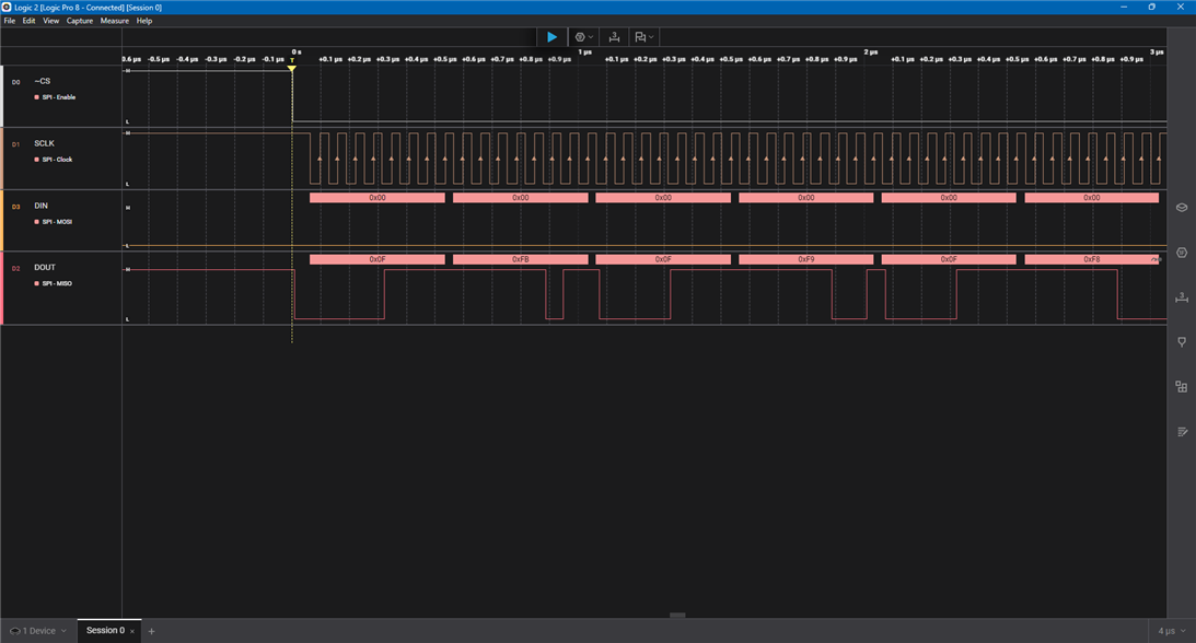

  • By the way, here is a capture where I am seeing correct operation. I have been cross-comparing against this. Let me know if you are able to see anything that might be different from your setup, because I have not up until now.
    Joel
