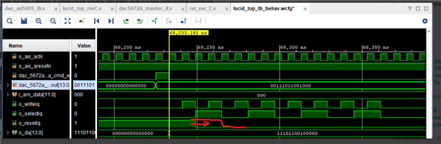

    On the ILA I see your ResetIQ should be with the falling edge of the SelectIQ. Can you try delaying it to the right? See below.

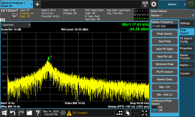

    We see a spur or some kind of a small "hill" at around 17.4KHz at -68dBm on the DAC5672A outputs (it is measured on the OPAMP output that is connected to the DAC5672A output, see drawing).
    Both OPAMPS outputs show it (A and B).
    It gets stronger as the DAC5672A output gets higher (the below picture shows it with DAC5672A digital input at maximum, around 0.5V at its output and 2V at the opamp output).
    It cannot be seen by scope since the voltage is around 400uVpp.
    Still, it appears on our product output and we need to eliminate it (it modulates into the signal output).
    It does not come from the DAC5672A power supplies (inspected AVDD) and not from the OPAMP (disconnected the OPAMP and inspected the DAC5672A output to find it at around -78dBm).
    It seems the DAC5672A is the source. Are you familiar with that? How do we eliminate it?

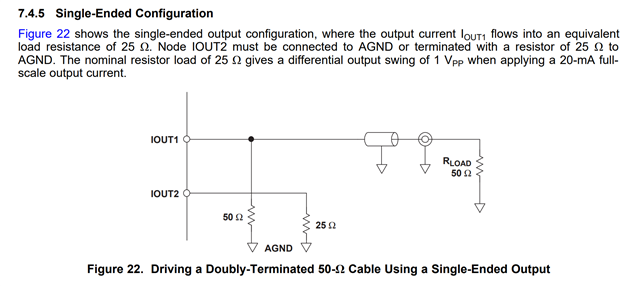

    Can you see the spur when the output is disconnected from the amplifier? When the both the outputs are just terminated?
    If you are using a spec analyzer to check this, since it is 50ohms. You will need to change the termination to reflect below.
    Otherwise, the output is lopsided.

    The 17.4KHz issue is solved.
    The EVB schematic has a 0.1uF capacitor in parallel to the BIASJ_A resistor, and there is a comment not to assemble it.
    This is the culprit.
    You can see below the energy around 2*17.4K, 3*17.4K, 4*17.4K (opamp output in my circuit).
    In the picture below the capacitor is not assembled:
    When it is assembled (my case), it affects the internal circuitry that creates the 20mA (IFS) out of the 1.2V (doesn't matter if internal or external) and/or the internal two control amplifiers and/or the circuitry that drives Iout, in a way that creates the 17.4KHz disturbance we see.

    We sent you the screenshot from the ILA.
    These are the controls presented to the DAC5672A.
    When I send data to the DAC so it outputs it as voltage, I need to perform these transaction twice before the voltage is updated on the DAC outputs.

    I think Rob was asking for frequency spectrum. Are you just looking at DC output? From the ILA screenshot above it seems like you are just updating from 0x000 to some other constant pattern, so a voltage shift alone.
    I've taken a look at this also and am wondering if the issue is due to reset_iq dropping while the clk is rising edge, and some timing is not being met such that you lose the entire first data word update. If you drop reset_iq on a falling clock edge like I show below in a modified version of your ILA, does this make the output update on the first transaction? Is that the problem here? If not I am not following what the exact issue is.

    You are correct. The problem is the output doesn't update on the first transaction (only on the 2nd).
    We do drop resetiq on the falling edge of clockiq (in our design clkiq and wrtiq are shorted).
    (you probably mistaken clkiq with axi_aclk which is an internal fpga AXI signal).
    So, we do everything as in the datasheet and the DAC5672 Interleaved Data Mode document, and it still doesn't work.

    Can you please send us an updated snapshot of your ILA?
    Also, please trying shifting SelectIQ to be high before first rising edge of the WriteIQ/CLKIQ.
