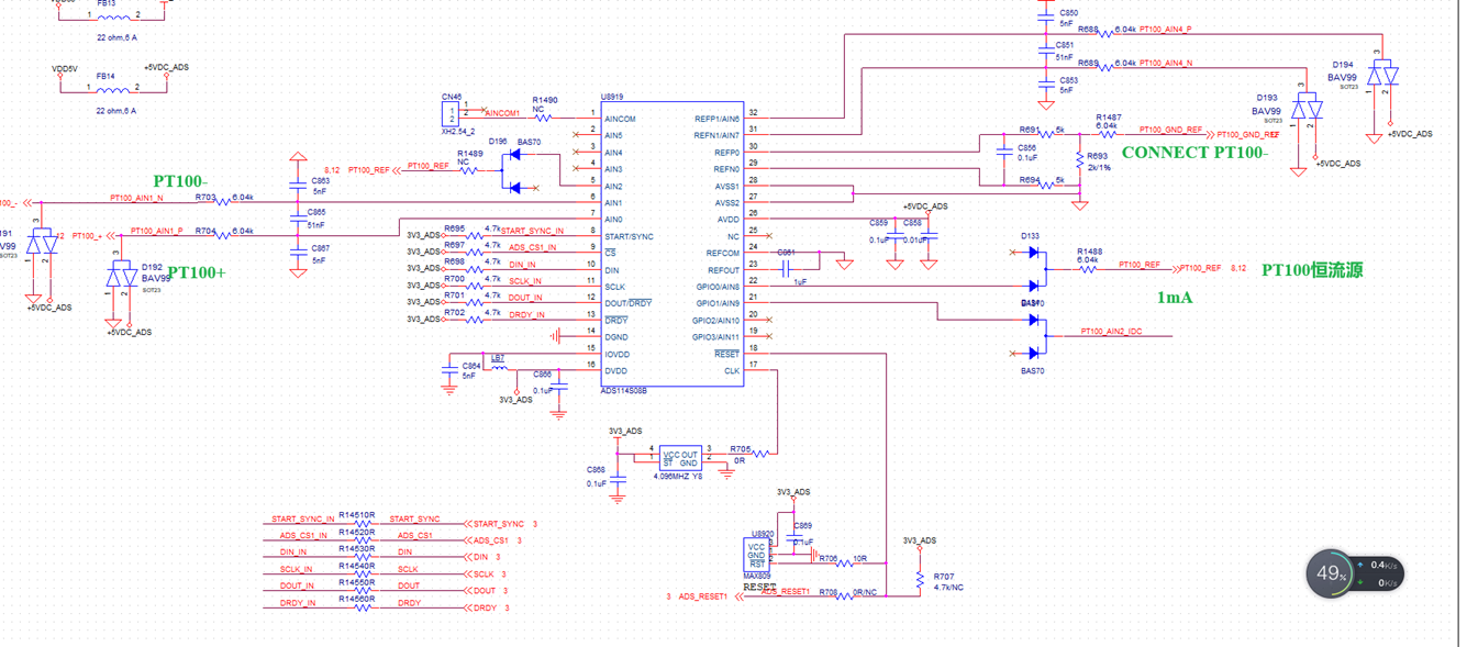

Part Number: ADS114S08B
We are using the ADS114S08B to design a 4-wire PT100 circuit. The design utilizes AIN8 as a constant current source (IDAC1), intended to provide a 1mA excitation current to the PT100 sensor. However, upon startup, the system consistently fails to output correct temperature data. The root cause has been isolated: the 1mA constant current source on AIN8 is not activating.
The software configuration sequence, derived from the system's debug logs, is as follows:
text
[GET] device id  = 0xc
[GET] cmd config status  = 0x80
[SET] cmd config status = 0x0
[SET] cmd config input multiplexer = 0x1
[SET] cmd config gain = 0xb
[SET] cmd config data rate = 0x14
[SET] cmd config reference = 0x10
[SET] cmd config idacmag = 0x7
[SET] cmd config idacmux = 0x28
[SET] cmd config vbias = 0x0
[SET] cmd config sys = 0x10
[SET] cmd config gpio data = 0x0
[SET] cmd config gpio con = 0x0
spi read ctrl u16Value = 0x1001
spi read ctrl u16Value = 0x10011335
