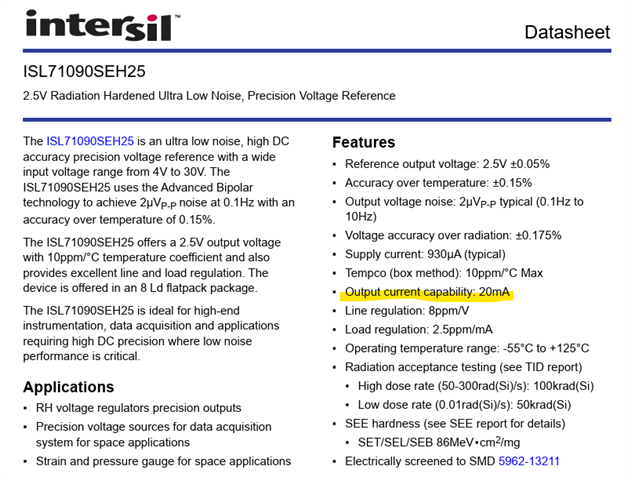

ADC168M102R-SEP: What is the required input current for the VREF inputs?
Part Number: ADC168M102R-SEP
I was looking in the datasheet for how much current the REFIO inputs need, and it looks like the datasheet is missing a unit:
I was hoping use just an intersil regulator to provide the 2.5V reference, but that can only provide 20 mA of current, and if that 50 above means 50 mA, then I will need more current.
  • Hi Charles,
    50uA is the typical spec for Iref. Should not be an issue to drive with the provided voltage reference.
    I'll make sure to note this down as a fix for the datasheet. Thank you for catching it.
