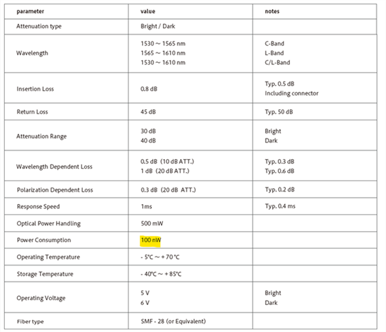

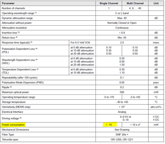

my customer have two VOA need a adjustable power supply.
but it only need less than 10mA supply current.
VOA_EN:
DTS0078:
voa_en.pdf DTS0078.pdf

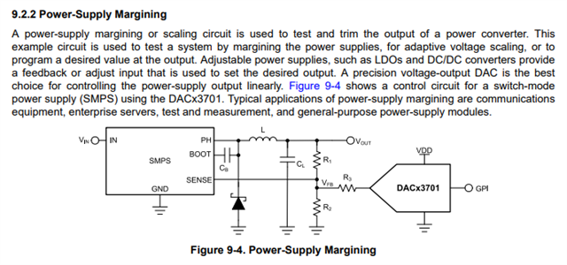

Vout 0~5V and they hope Vout can be controlled by I2C/PWM.
Do you think DAC is suitable for them? or they need additional power circuit as below.
