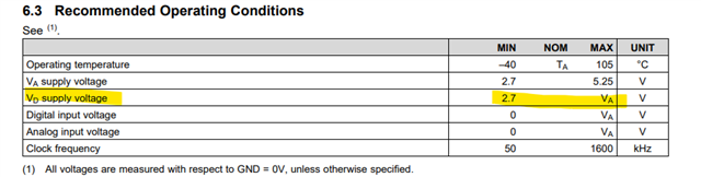

Hi Team,
Customer would like to confirm if ADC128S022 VD can support 2.5V ? our recommend voltage is 2.7 ~ VA
Thanks & regards
Eddie

Hi Eddie,
VD is strictly 2.7V minimum supply voltage. Operation or integrity of the digital interface outside of this is not guaranteed.
Joel
