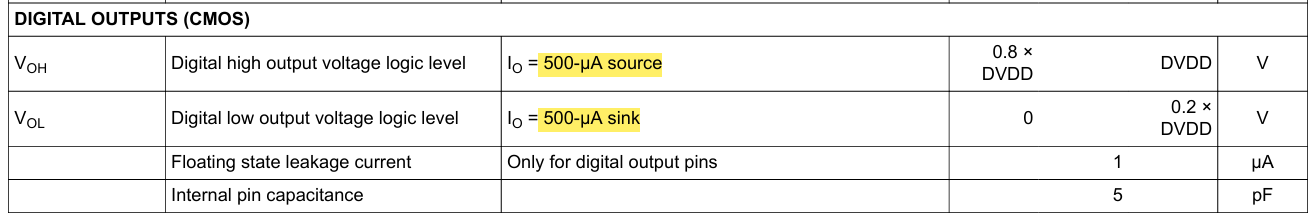

Could you tell me the maximum Io values for the “SDO pin” and “GPO pin.”?
Since the datasheet only listed the conditions mentioned below.
 I could not find any information in the datasheet regarding the maximum current that can be carried by the SDO pin.

  • Hello ttd,
    Those are the max values ±500μA
    For driving a photocoupler or something that requires higher current to drive, I would agree with the buffer/driver addition.
    We typically recommend a resistor in series, something like a 22Ω or 33Ω, but if a capacitor is preferred I would recommend something small, ideally something less than 22pF.
