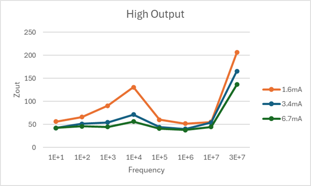

Which is the output impedance of the AMC1336 DOUT pin ?

Good afternoon Juan,
The DC output impedance of the AMC1336 is roughly 29.4Ω at the low output (0V) and 35.4Ω at the high output (3.3V). If you would like the output impedance at different frequencies, you can refer to the graphs below.
