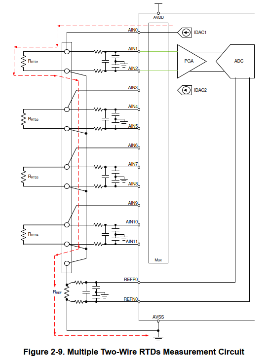

i would like to use ADS1261-Q1 in my application, but i'd like to test some of its features on ADS1261EVM. In my case i have to read 9 PT100 sensors and i was looking for a possible configuration to do that: i read application note SBAA275A "A basic guide to RTD Measurements" and maybe the most suitable solution would be the one reported here below.

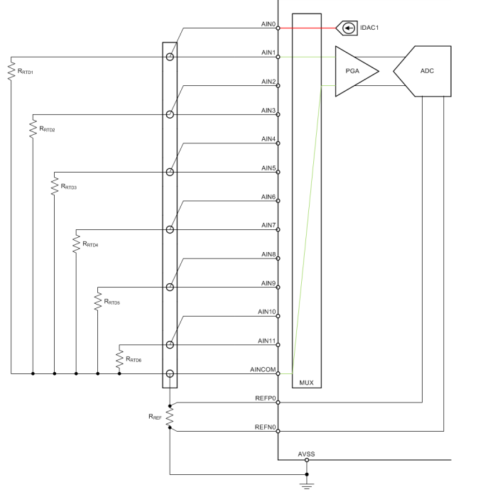

In my understaing, this would lead to multiple ADS1261 to be used, because one ADS1261 could handle just 2 PT100 (for ADS1261 IN0 and IN1 would be configured as REFP0 and REFN0, and the remaining 8 channel must be configured as 2 differential input and 2 IDAC source). I think that it is not so efficient as solution so i was looking for something different: here below i report a possible configuration that i found in topic for ADS1248.
So my questions are:
  • is ADS1261EVM suitable in order to evaluate all the different configuration i was talking about?
  • Which configuration is the best for 9 PT100 from your point of view ?
  • in the configuration from ADS1248 topic, how do you configure input filter?

  • Hi Giorgio,
    Welcome to E2E!
    The main tradeoff of the solution you shared with ADS124S08 is that you cannot have differential filtering. You could put a single-ended filter for each odd AIN channel + AINCOM, but Joseph recommended that schematic if you don't need any input filtering.
    This is the input schematic for the ADS1261EVM:
    You would have to modify the channels you use for the IDAC output to remove the filtering. You could remove the capacitors and replace the series resistors with 0ohm resistors.
    Maggie

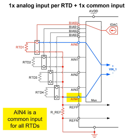

    I would also like what is the difference between referrinf negetive terminals to AINCOM, as saide before, and to REFP as i saw in precision lab series video (i report a screen here below):
    Giorgio
  • Hi Giorgio,
    The AINCOM pin can be connected to a level-shift voltage:
    If a level-shift is not required, then you could use any analog input pin as the common negative input, such as AIN4 in the image you shared.
