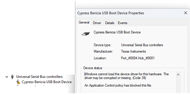

•I attempted to display data in HSDC Pro (High Speed Data Converter Pro) using the TSWDC155EVM together with the ADC3669EVM-DC, but no data is displayed.
•I followed the procedure described in Section 2.3, "Hardware Setup," of the EVM User‘s Guide: ADC3669EVM-DC exactly as instructed.
•According to Step 3 in Section 3.3, "Using the GUI," several LEDs should illuminate when the GUI launches correctly. However, I do not observe this behavior in my setup.

    I was able to find the several LEDs to turn on and the FPGA is now being recognized after changing several resistor values. However, I am still unable to capture any data.
    One difference I noticed compared to the procedure described in the ADC3669EVM User Guide is that when I open HSDC, the figure in the User Guide shows "FT2UW79X-TSW1418" under Select Board, whereas in my case nothing is displayed there.
    For reference, Device Manager shows "Cypress Benicia USB Boot Device". When I open its Properties, the following error message is displayed:
    Windows cannot load the device driver for this hardware. The driver may be corrupted or missing. (Code 39)
    An Application Control policy has blocked this file.
    I am not sure whether this error is related to the data capture issue, but I wanted to share this information in case it helps with troubleshooting.
    Someone in TI reported the same problem. I will post the statement here:
    A few days ago I brought up the ADC3669-DC EVM with the TSWDC155EVM for the first time and was able to get a capture. Have you verified the clock is correct and/or it is filtered correctly? Are you inputting the correct tone to the EVM and/or filtering that properly if using a filter? Please go through the steps again, I verified them today.
    Have you checked the path to make sure it is correct? Is everything exactly as in the User Guide?
