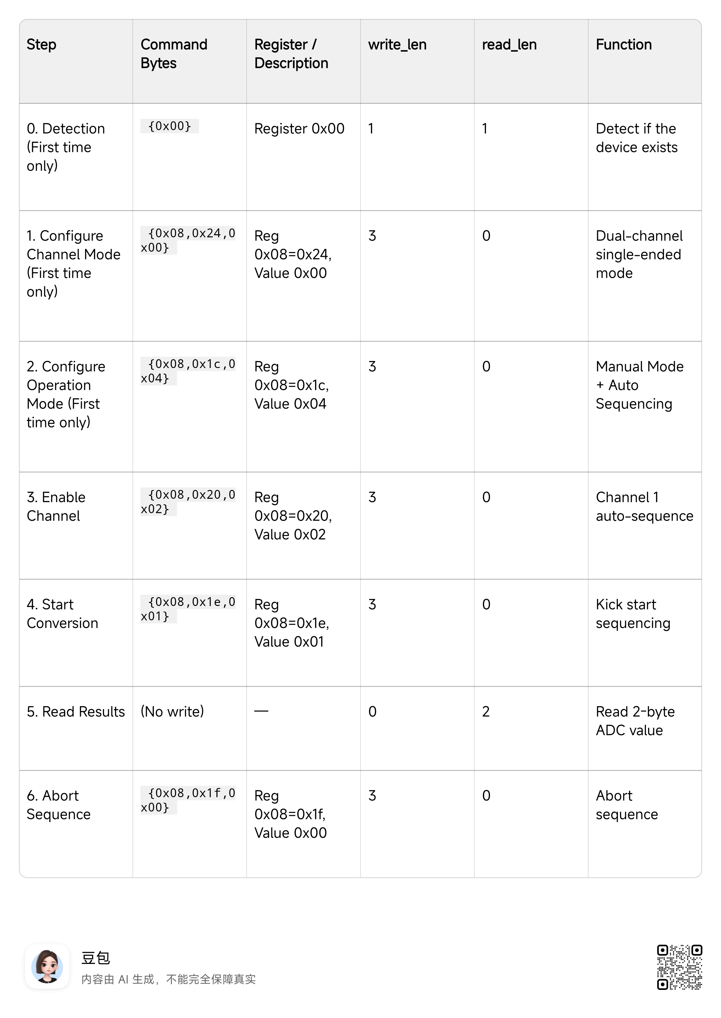

My customer is using ADS7142 in server, the input voltage is 1.7V but readback value is 0.1V. they are using the manual mode auto sequencing.
the initializaiton steps is shown as below, it seems good.
there are two reasons may lead to this issue.
(1) the initializaiton steps is not good. some chips can work well, some cannot.
(2) the chip damaged.
For the (2) suspect, customer also reads the 04h register, it is 0A. but in datasheet, the 3bit should alwasy be 0. so customer thinks that the chip damaged. Could you share your insight? why the 3bit becomes 0?

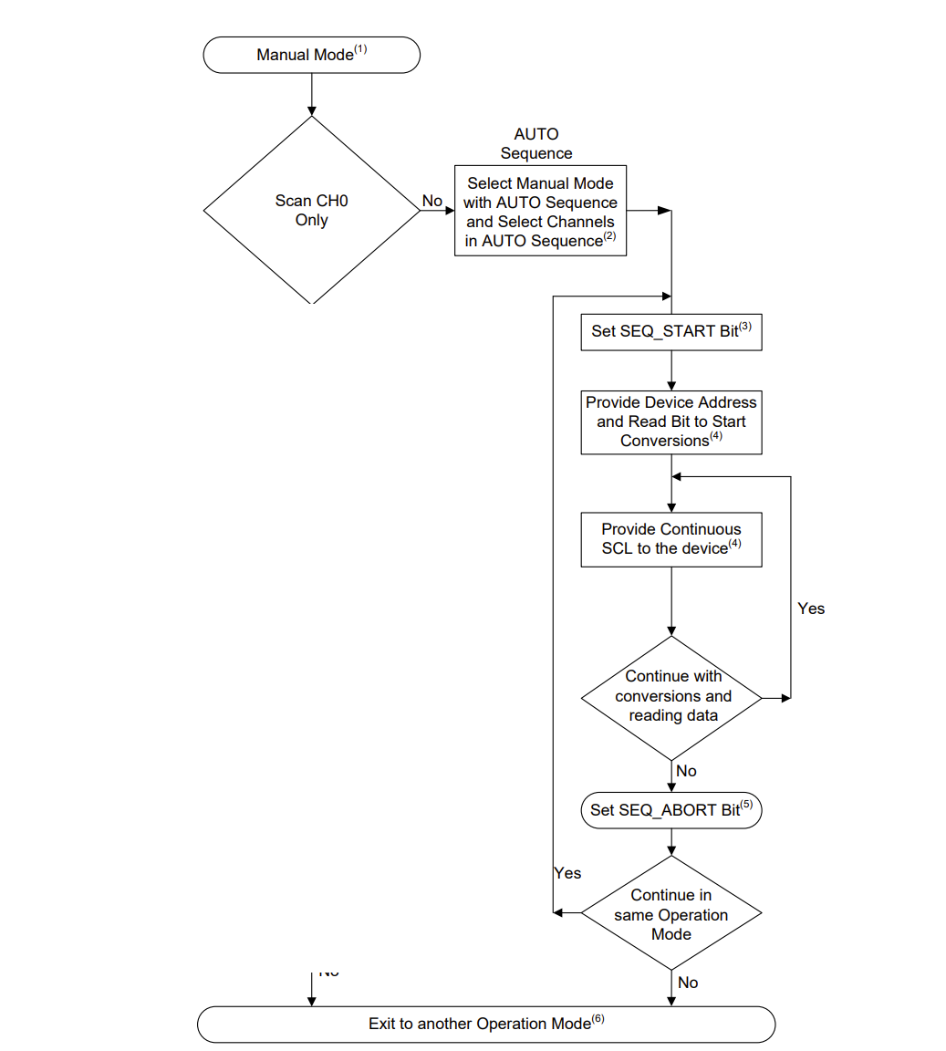

    Step 6: Abort Sequence does not look entirely correct.  Bit 0 has to be set to 1 in order to abort the sequence.
