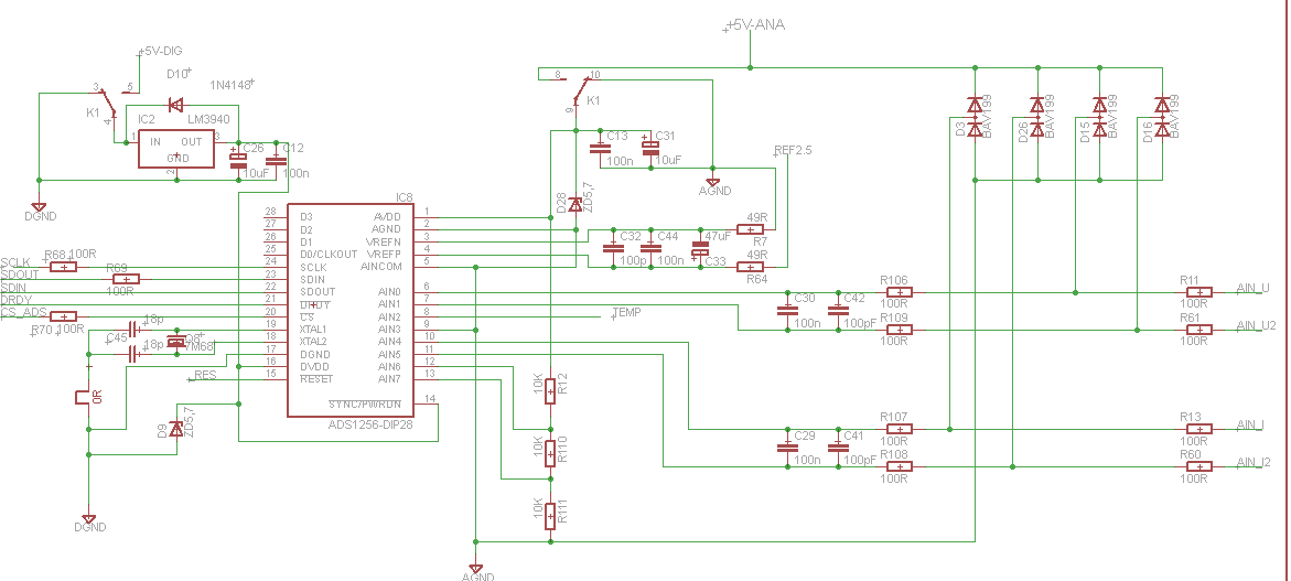

    i have totally reworked the design of the PCB layout.
    Digital voltage:  Protected with 3.6 V Z-diode
    Analoge supply:  Also protected with 5.6 V Z-diode.
    Please find below the shematic.
    The new PCB will be finished in a few days, then i can see if the problem with the wrong measurement is still there.
    The relay K1 is to hard-reset the ADS.  R10,11,12  will be used for testing the ADS1256 function. If this measurement is wrong, K1 will be switched off for 1 second.
    My question is:  In the datasheet of the ADS1256 page 28 figure 25 are two resistors 49.9 Ohm shown on the reference input.
    What is the reason for this strange value ? Can i use two 50 Ohm resistors ?
    Thanks in advance.
    Dirk

    well i have finished the new circuit board with all protection parts shown in the above circuit.
    But the ADS1256 is still not running stable, if the EMI impulse happens.
    The ADS will change sample rate afte the Impulse happened.
    A Reset over the Reset pin does not work, so i still have to cut off the power for 200 ms to totally reset the device.
    Dirk.
  • Dirk,
    How do you have your analog and digital grounds connected?  There can never be more than 300mV separation between them.  Can you send us your layout for review.
    Bob B
  • Hello Bob,
    thanks for your answer.
    Please find attached the Layout and schematic for power supply.
    The analogue and digital ground comes from the ATX plug.
    It is connected in the power plug.
    The ADS1256 is assembled with an adaptor board from SSOP28-DIP28. You can find it below the ESC button between the diodes D9 and D20.
    I think i will make a test and connect both grounds direct under the ADS1256.
    Kind regards  Dirk

  • Hello Bob,
    the problem is solved now.
    The reason was was totally different from the things we have discussed until now.
    In my application some SPI devices are connected to the SPI master. The length of the SPI clock line is about 30 cm in total.
    The source of the SPI clock was not terminated with a series resistor. So i think there were some reflections on the clock line.
    So i put a capacitor direct from the SPI clock input pin of the ADS1256 to GND. With the allready existing series  resistor 100 Ohm a low pass filter is working for a SPI frquency of 100 KHz.
    Additional i do a reinitialize of the sample rate every second.
    Now the system runs stable.
