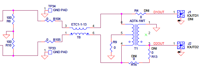

  • Hi Kang,
    I've another question about the baseband output. I need baseband outputs with a dc offset. In particular I need signals with dinamic from 0 V to some value. Is there a way with this evm for this purpose? Otherwise, can you suggest me what could be a solution?
    Thanks in advance.
    Cia
    Simone
  • Hi Simone,
     A simple way is to set R6 and R10 to be 25 ohms each. You will need to remove T8 balun and T1 transformers to remove the AC coupling components. To route the differential pairs straight out to the J1 and J2 connector, you will need to install R4, R16, and R13 zero ohm resistors.
    With the default 20mA full-scale and 25ohm load on each leg of the diff pair, you created a 0.5Vpp SE swing (or 1Vpp diff swing) with common mode of 0.25V. This is assuming you are connecting high impedance probes to J1 and J2. If the probes that you are connecting to J1 and J2 are 50ohm, the impedance will change and you will need to adjust you R6 and R10 value.

  • ok Kang, perfect. Many thanks.
    Can I ask where I can find the schematic of the board (rev. F)? Because in the board webpage I see only the schematic file for rev. D.
    Thank you.
    Cia
    Simone
  • Hi Simone,
    The schematic is attached. We will upload the design package to the web soon.
    -KH
