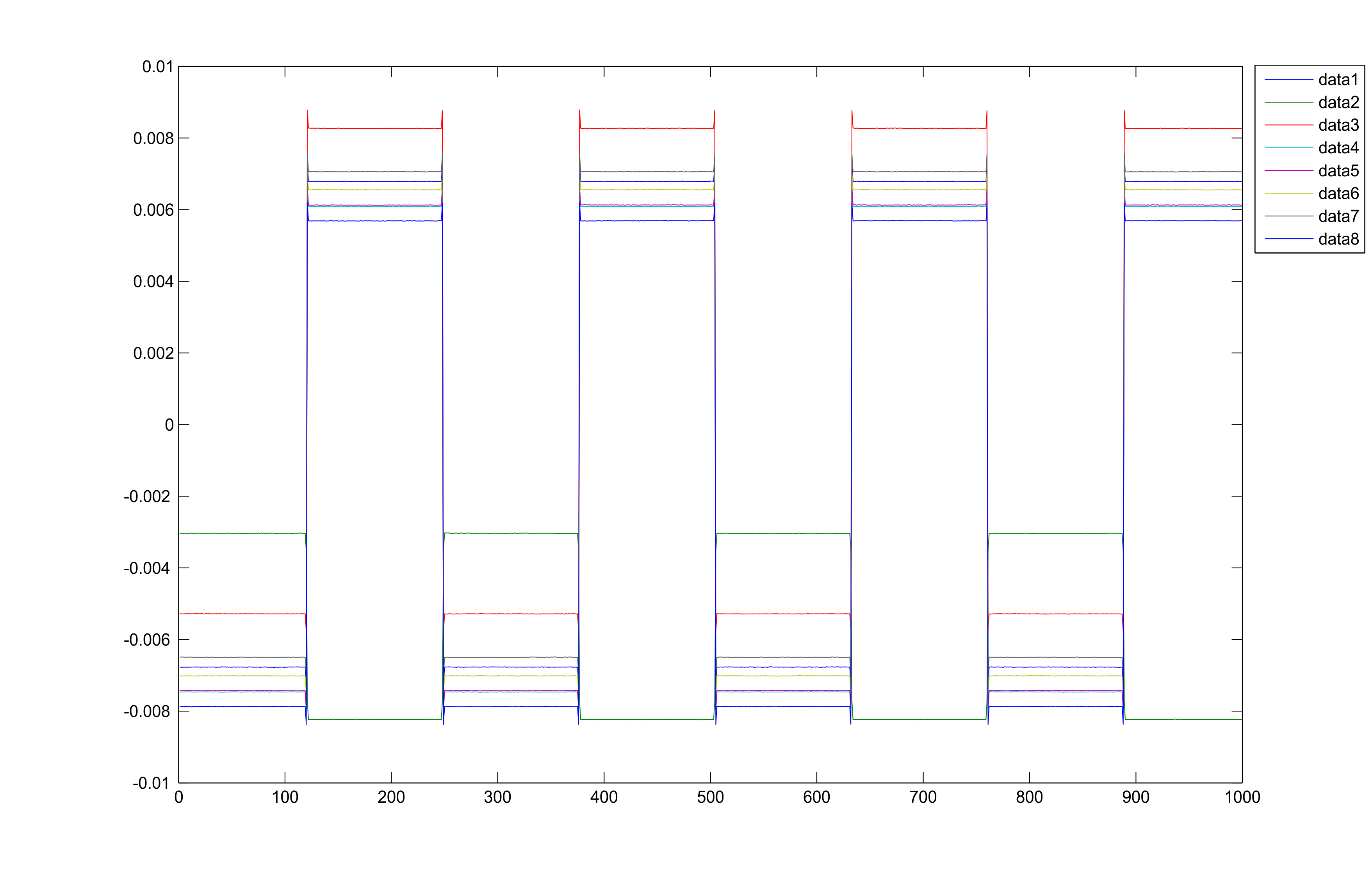

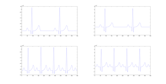

I have a strange problem with ADS1298. When applying a patient simulator to the EVAL Board (in combination with a own dsPIC board), only channels 2 and 3 work proberly (see pic ecg.png - the 1 colum is channel 2, the second colum is channel three). For all other channels (1,4,5,6,7,8) the ADS1298 sends 7F FF FF (which is an overflow) via SPI. The testsignals (see below) are also not bad for all 8 channels.

all channels are configured for NORMAL INPUT, 500 SPS, HIGH-RESOLUTION
- when attached to the mmb0 board everything is fine.

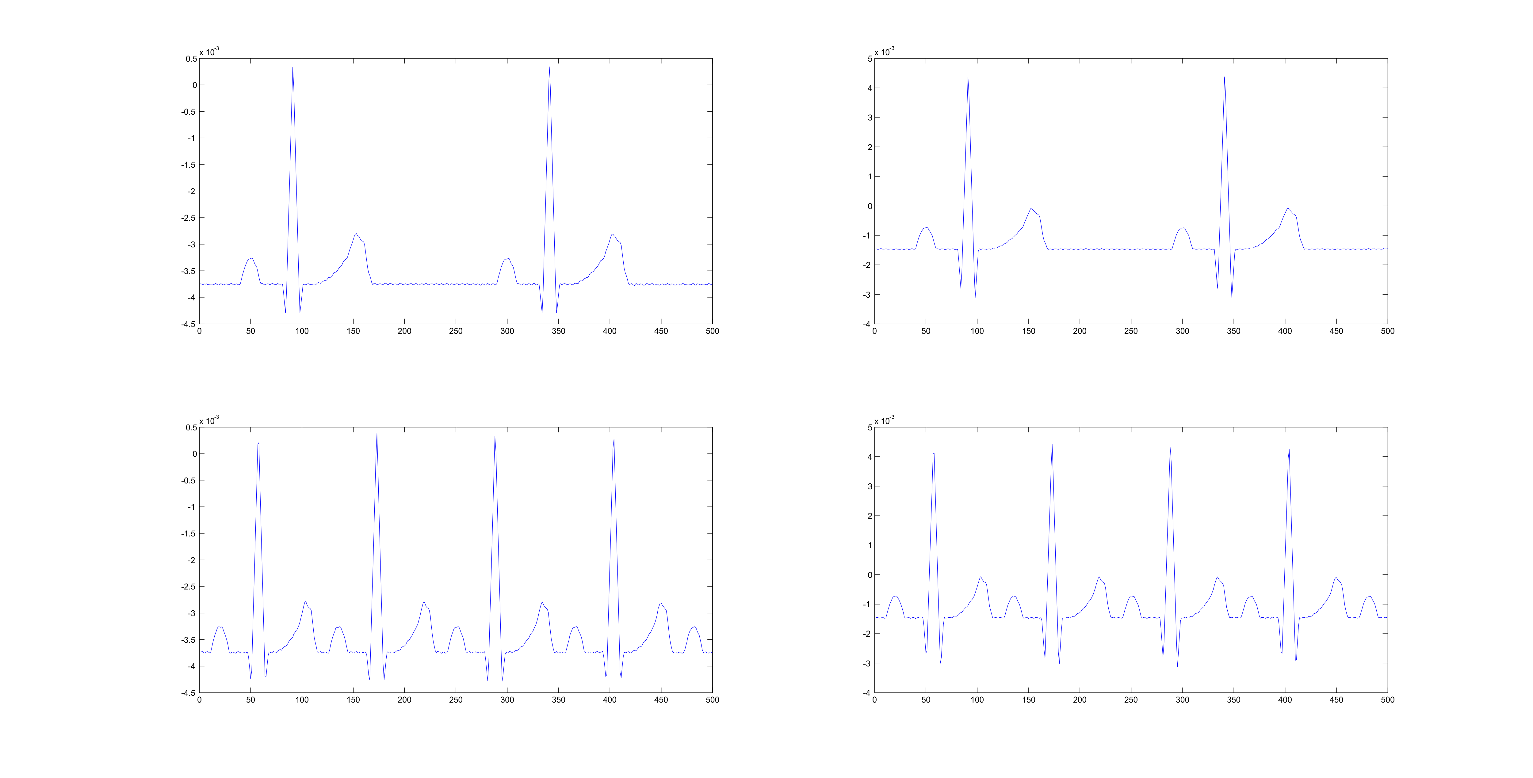

    you were right. Now it works with the WCT1 and WCT2 you proposed.Is this offset normal?

    Even though the electrodes are performing a single-ended measurement, the ADC requires a differential input.  By enabling the WCT, you are connecting the negative input terminal to WCT - essentially the common mode voltage that the patient should be at (is typically done using RLD).  You can turn off the WCT, but then the negative input is floating (as was in your case) - so you would need to connect the terminals to some other voltage that make sense for your system.
    Most EKG applications utilize the connection to the WCT, so unless you are doing something completely different, this is probably the best way to go.
