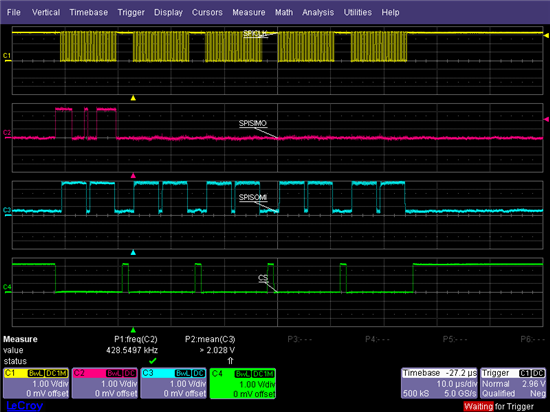

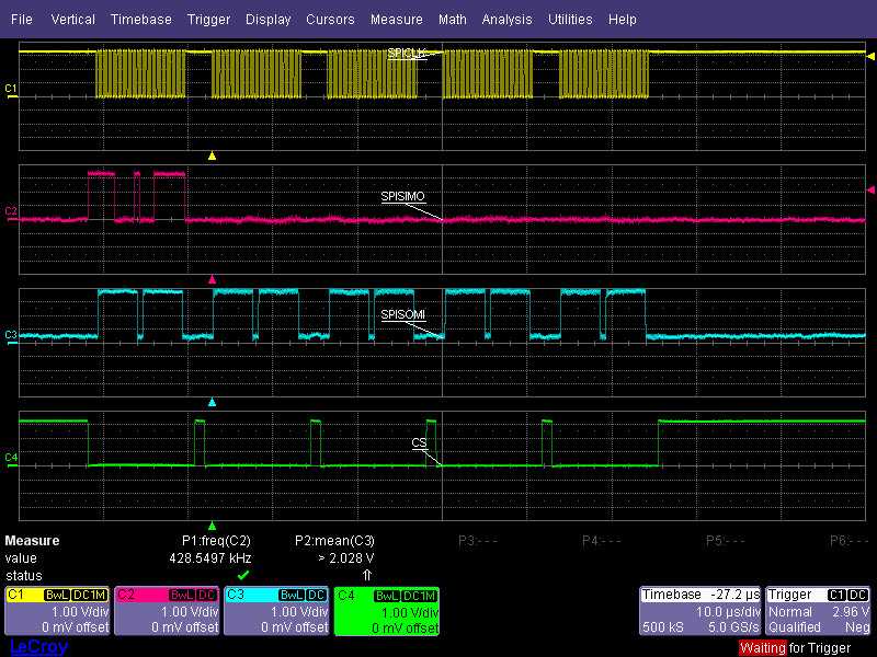

I am trying to send 2 x 16-bits words  0xFE03, 0x07FF (one after another) to the control register but what I receive from the ADC is unclear. The DSP recognizes 0x7FFE on its input of the SPI port.
Here is the screenshot from one of the tests.
I suppose that the ADC converter should send back the control register but it does not. The question is - why?
I will be grateful for any suggestions. I will also willingly provide further information about the ADC/DSP configuration if they help to solve this issue.

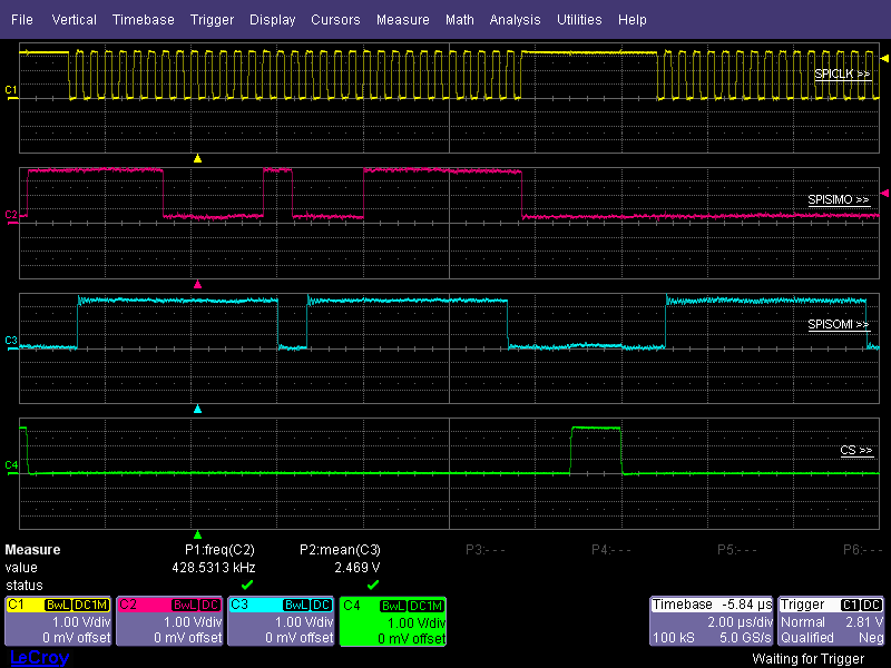

    Here is zoomed screen shot of the control register which I try to send to the ADS8556.
    I attached also the pin assignment.
    Is there any reason why does the communication operate in this way? How make it to work properly?

    I don't see anything in your spreadsheet that would cause the register content not to be sent out of the SDO line.  Can you verify the voltages on the analog and digital power pins, that the RESET pin toggles high to low?  Also please check that the STBY pin is at a valid logic high.  There are a few connections missing that will have an impact on performance (inputs floating, REFC_x floating), but you should still be able to read the registers.
  • Hello Tom
    The voltage levels were correct . In another post I read that toggling RESET pin before sending configuration is desired (at least 50ns up) - that is what I did. The STBY pin (as I wrote in the attached file) was connected to +3,3V (BVDD).
