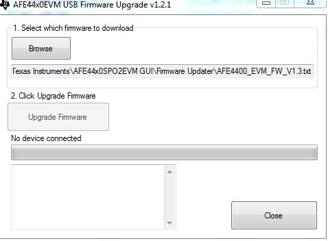

I just received the evaluation board, AFE4490SPO2EVM and tried to install the S/W and USB driver according to the manual. S/W installation is succeeded.
However, I couldn't install the USB driver in the PC.
After I connected the AFE4490SPO2EVM to the PC via USB cable, AFE4490SPO2EVM is assigned to USB input deive (HID) so, "AFE4490SPO2EVM " or "FE44x0SPO2-FE EVM" are not displayed.
And I tried to update the USB input device driver to "FE44x0SPO2-FE EVM", however the update wizard couldn't find the device driver,"AFE44x0.inf" in the selected folder,"C:\Program Files (x86)\Texas Instruments\AFE44x0SPO2EVM GUI\USB Driver".
I tried that on three kinds of PCs(Windows 7 / Windows 7 / Windows XP) but all of those exhibited the same behavior.
Could anyone help me how to install the USB driver?
