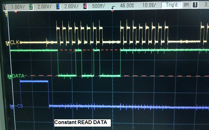

I have the ADS131E08 EVM attached to an MSP430F5418. I need to read the A2D using SPI - UCSB0SPI.
The wiring is as follows:
MSP430 f 5418 Desc. EVM Board
P3.0 SPI_CS JP8.2
P1.1 SPI_Start JP9.2
P3.1 SPI_IN J1.11
P3.2 SPI_OUT J1.13
P1.2 SPI_DRDY J1.15
P3.3 SPI_CLK J1.3
  GND J1.18

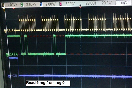

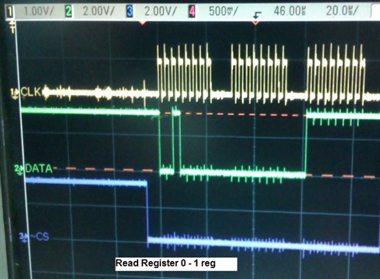

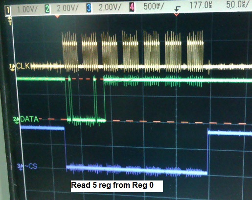

I'm trying to read the registers of the ADS131

	ADS_131_ReadRegister(0, 1, &(TempData[0]));
	ADS_131_ReadRegister(0, 1, &(TempData[1]));
	ADS_131_ReadRegister(0, 1, &(TempData[2]));
	ADS_131_ReadRegister(0, 1, &(TempData[3]));
	ADS_131_ReadRegister(0, 1, &(TempData[4]));
, and I'm not getting correct values. Also, if I read register 0 a few times, I get different values.
Attached is the code I'm using to setup the SPI and registers. I'd appreciate any help.
