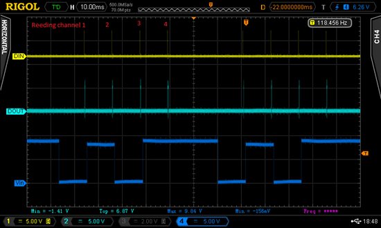

I use ads1281 for reading 4 different input.
It is configure like that :
Pulse sync mode,4000SPS,Linear phase and Sinc + LPF filtre block
I use the read by command
I turn the first channel on and then I wait for the signal to be established and then I run a command to read the value then I disables the channel. I do the same for the 3 other channel except for the fourth where I expected to have to read the first channel again to disable.
I do that about 80 times by second but the probleme is the ADS returns  the same value as the fourth channel to any other channel
In this picture I wait a lot of time between each reading and its work but in the case were I read as fast as I can i do all the reading in 6 ms.
Do you have any idea wy y have this probleme ?
I use the same schema as the evaluation board .
Thanks in advance.

    Do you monitor and wait for /DRDY to go low before reading the data?
    In SINC + LPF mode, the ADS1281's digital filter requires 62 conversion cycles to settle! At a data rate of 4kSPS, this means the first conversion is settled after 15.5 ms.
    You must be externally muxing the input channel. I think what is happening is you're switching channels and reading the next conversion result which is unsettled!. The SINC + LPF essentially keeps a long moving average of the previous conversions, and waiting just 1 conversion cycle (with the new input channel) is not having much affect on the conversion result.
    After you switch channels you will need to re-synchronize the ADS1281 and wait for /DRDY to go low. This way you know that the digital filter has settled to the correct value.
    If you do not want to wait so long between conversions, you can use just the SINC filter. Refer to Table 11 in the ADS1281 data sheet for "Time for data ready, tDR".
