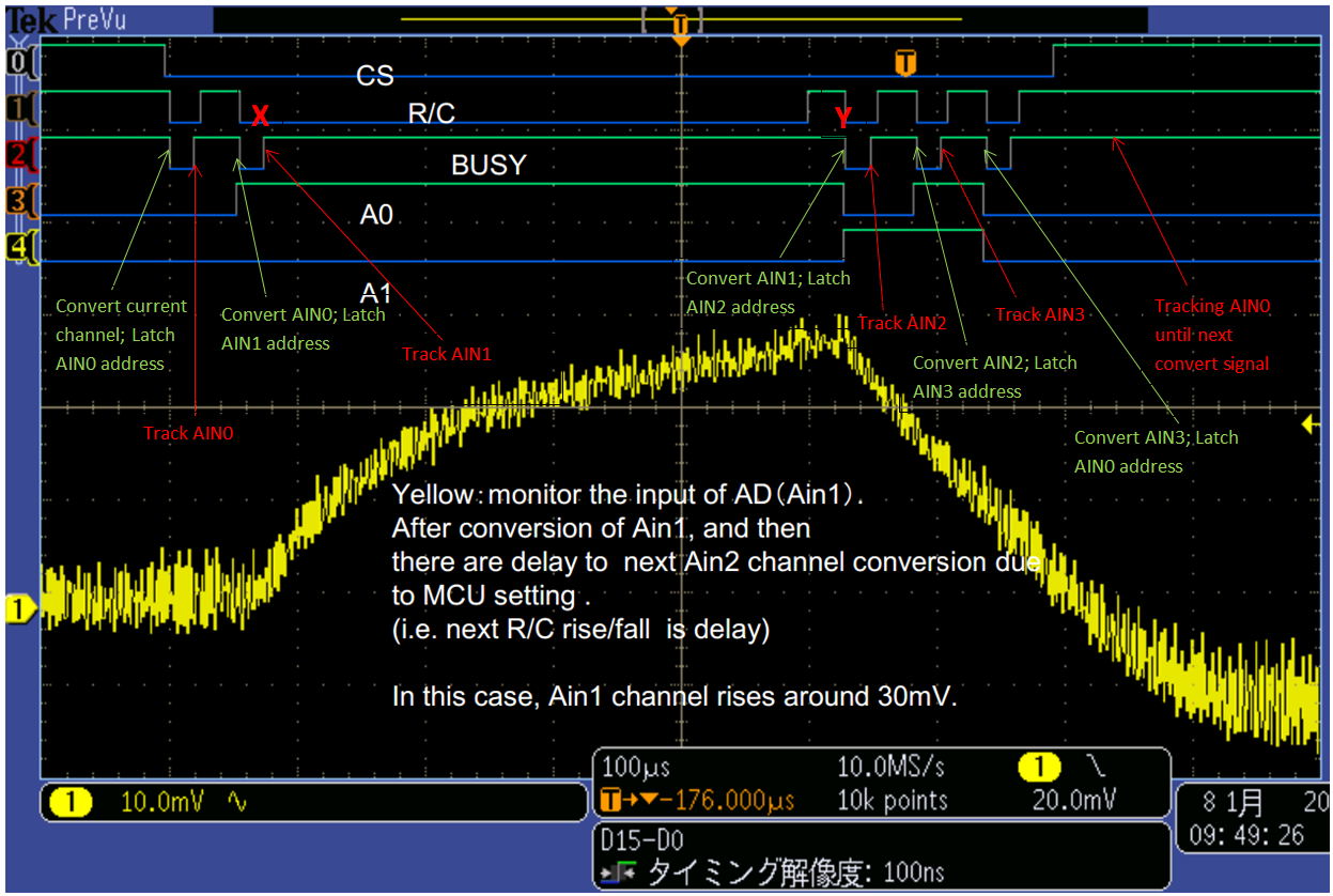

    Here is the questions about  ADS7825 again.
    Here I had summarized  our questions Q1~Q4 in attached pdf file and also customer's problem.
    We do not know about channel selection and CDAC mechanism well, so please allow me such a complicated questions.
    Customer is so in hurry because they are stopping the production , so , please advise within a few days
    Customer is investigating the timing for R/C. but customer hopes to understand the internal operation in the ADS7825.

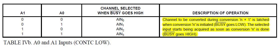

    (Q1) The status of SW2 does not depend on t1 (convert pulse width). Channel selection is correlated with the state of the /BUSY signal as given by Table IVb, for Manual Channel Selection mode, which is what the customer appears to be using.
    (Q2) When /BUSY goes high, SW2 switches to the channel whose address was latched on the previous falling edge of R/C (see highlighted comment above)

    I'm not sure why the input was at 62mV but perhaps it is being loaded by the ADC? There appears to be some confusion as to which channel is being converted during a given ADC conversion cycle. Using the comment highlighted in Table IVb above, I have associated the operational states of the ADC with the customer's timing diagram as shown below:
    My guess is that the customer assumes that AIN1 is converted at point "X" when in fact AIN0 is converted. If AIN0 is floating at this point and the sampling switch is still closed then the voltage measured at AIN0 is simply the voltage across the sampling capacitor which may have been 62mV at the time of measurement.
