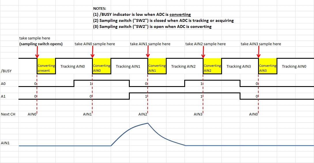

Is the timing diagram in attached sheet ( my understanding)  correct?  ( Thank you for your answer to seishin)
# Question2
My understanding is CDAC acquire the analog voltage of AIN1 when SW1=SW2=AIN1.
In this time, customer's concern is voltage rise depend on input cap..
ADS7825 acquire the voltage just at the edge of BUSY goes UP? (  My hope is , there are
No concern about the A/D conversion result even though we can see the rise of analog voltage .....  Is it correct?)

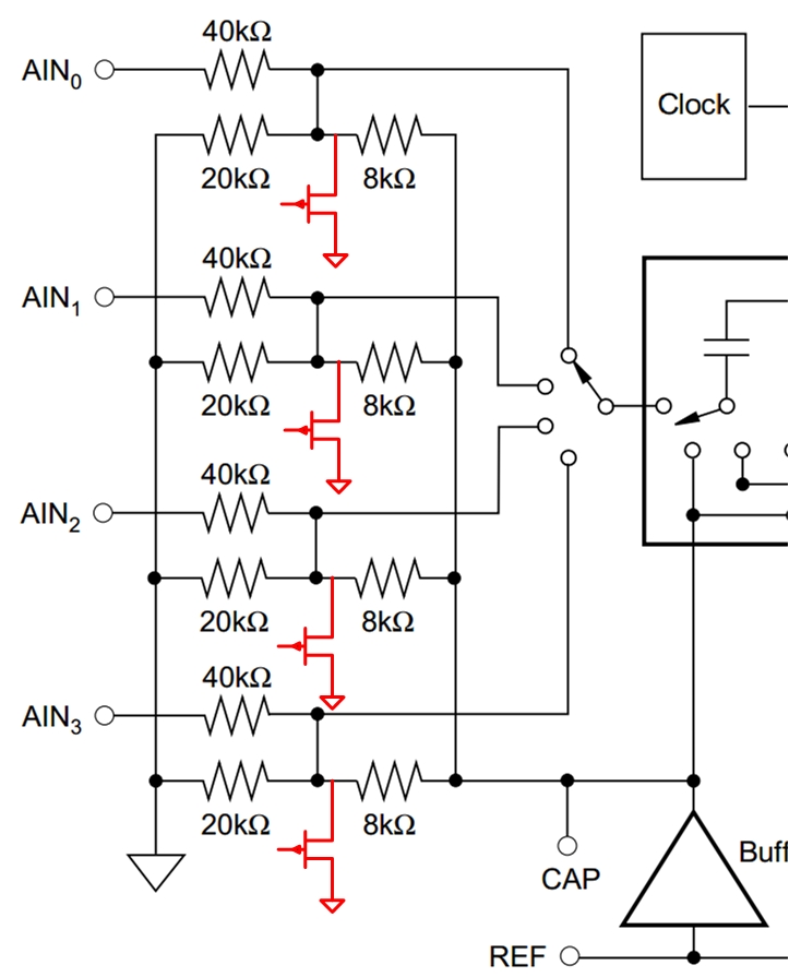

From Customer's test result, AIN1 analog voltage start to fall to 62mV ( seishin's thread) when they had selct AIN2.
In this time, SW1/SW2 swtitches  from AIN1 to AIN2.  Here is the question.
Don't you have any additional switch (SW_x) who discharges the parastinc cap to ground   in front of the SW1 ,, do you ??

    Q1) Your understanding of the timing diagram is more or less correct, but I would like to emphasize a couple of important details that might help clarify the operation of the part:
    Q2) The ADS7825 starts acquiring when SW1 and SW2 are closed. The voltage across the sampling capacitor tracks the input voltage as long as the switches remain closed. At the end of the sampling window, the sampling switch opens and the voltage on the sampling capacitor is then converted by the ADC. So the input sample to be converted is acquired just before the falling edge of /BUSY when conversion begins.

    Q3) I was able to find partial schematics of the ADS7825 input circuit and you are correct - there is an active pull-down to GND on each of the input lines:
    It appears that under normal operating conditions, the inactive channels are pulled down to ground which would explain why AIN1 approaches 0V when AIN2 address is latched. What is the customer measuring on AIN0 and AIN3 when AIN2 is addressed?

    I apologize for the delay in my response. After our last correspondence I decided to put together a test setup to verify the functionality of the ADS7825. That took some time but the test results confirm that the ADS7825 behaves almost exactly as I have described to you. Here are my observations:
    - Upon power-up, the input channel corresponding to the prevailing [A0, A1] setting is selected
    - The selected input channel (summing node before switch) is internally pulled up to 1.79V and all other channels are pulled down to about 50mV (you cannot sense the internal summing nodes unless the AIN* pins are left floating)
    - When a convert signal is issued, the ADC takes a sample of the selected input channel (sampling switch opens) on the falling edge of /BUSY and starts converting it
    - The falling edge of /BUSY is also used to latch the address of the input channel to be selected for sampling on the next rising edge of /BUSY
    - During conversion (while /BUSY is low), *all* input channels (summing nodes before switch) are internally pulled down to GND
    - When /BUSY goes HIGH, the ADC starts acquiring the input channel corresponding to the value stored in the address register
    Please see the attached file for actual test data.
    With regard to your question relating to SBAA043, once again the description of the sampling process is consistent with my explanation - a sample is taken only when the sampling switch opens at which point the voltage across the sampling capacitor becomes constant. This is the voltage that is then converted by the ADC. Please see excerpt below from SBAA043:
    The only difference between the ADS7825 and the ADS574 is that the sampling switch opens on the rising edge of STATUS on the ADS574 but on the falling edge of /BUSY on the ADS7825.
    Harsha
