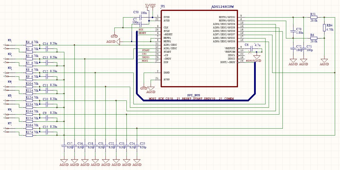

I have an application for measuring temperature using ADS1248 and 2-wire connection of Pt1000 sensors. The schema is in the first picture bellow. For controll the ADS1248 chip I am using ATmega8 microcontroller.

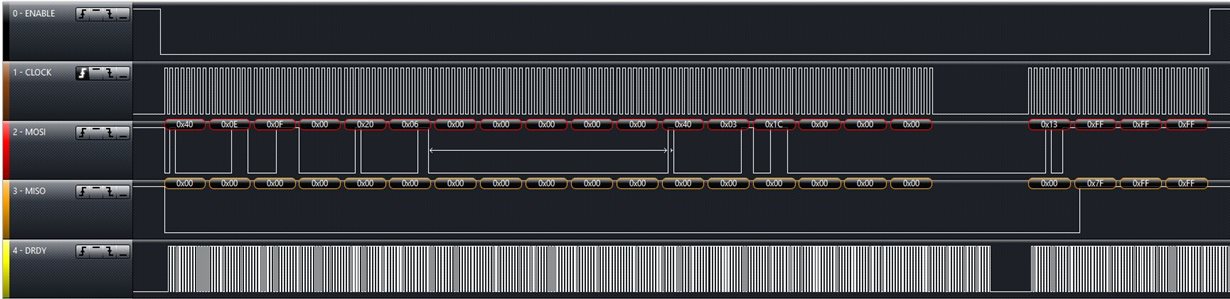

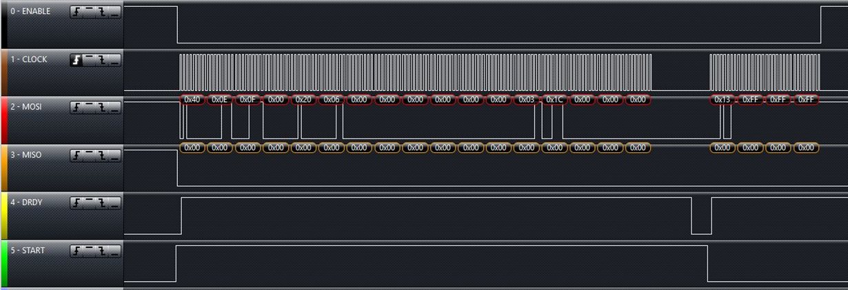

I am able to write (WREG) and read (RREG) a configuration registers. Now I have connected two Pt1000 sensors as example for trying function. I have a problem with reading data register once (RDATA) as you can see from logic analyzer diagram. I am not able to read any number (only 0x00 - 0x00 - 0x00).

unsigned char WRITE[] = {0x40, 0x0E, 0x0F, 0x00, 0x20, 0x06, 0x00, 0x00, 0x00, 0x00, 0x00, 0x00, 0x03, 0x1C, 0x00, 0x00, 0x00};
and RDATA sequence:
unsigned char RDATA[] = {0x13, 0xFF, 0xFF, 0xFF};

    I wrote 400000h to the FSC register. Now I am reading value 0x7F - 0xFF - 0xFF. I thing this is some full scale value.

    First of all, what is your SCLK rate and what is the rate at which the DRDY is clocking out? I can't think of why DRDY would clock at a very fast rate, so make sure that you have clipped onto the correct line.

    Reading a value 7FFFFFh does refer to the full scale. It looks like right now, you have the RTD (or resistor) connected from AIN1 to AIN7, and the IDAC current is sourced into AIN1 to go through the RTD, then through RBIAS.
    The problem in your setup right now is that you have filter resistors that are very large. Right now the current from the IDAC goes from AIN1, through the 4.7k filter resistor, then through the sensing resistor, through the other 4.7k filter resistor, and then to RBias. This way your input voltage is much larger than the reference voltage. From the input measurement, it looks like ((4.7k+4.7k+RTD)*250uA). Which is going to be larger than 4.7k*250uA. If you want to confirm that, you can measure the voltage at AIN1 to AIN7 and see what voltage you get. Then measure the Rbias voltage for comparison.
    To start out, replace your filter resistors with 0 Ohm resistors or shorts. This should at least give you a value that you will be able to read. Based on the logic analyzer output, it still looks like you have some problems with the data readout. Just confirm that you'll get something other than 7FFFFFh when the input filter resistors are removed.

    The DRDY signal isn´t oscillating now. I replaced 4k7 filter resistors for 0R resistors. Values of these filter resistors was really incorrect. Digital values and calculated temperature values are ok now.
