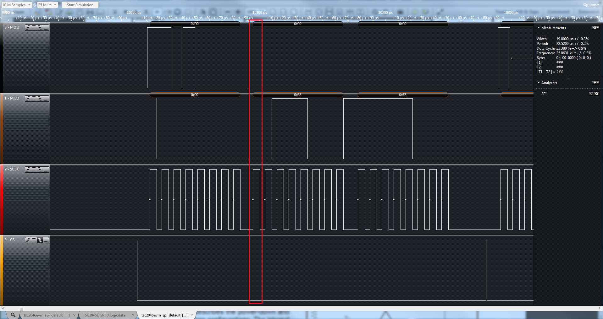

Now I'm debugging the tsc2046ipwr on i.MX7D platform using Linux 3.14 kernel, the driver I used is  ads7846.c.
after probe, X+ and PENIRQ keep high, In normal condition, if I touch the screen, X+ and PENIRQ will change to low, when my finger leave the screen, the X+ and PENIRQ will return to High level.
But accutually, I meet this issue:
Once I touch the screen, the pin PENIRQ changes to low level, and keep low even my finger leave the screen, and driver will continue send SPI comand and report input message. X+ return to high level, but X+ will never change to low level even if I touch the screen( just a little reduce at this time).
In this driver, I see that, every cycle, the last comand is PWRDOWN, this should make tsc2046 go into power-down mode.  And according to the SPEC, in power-down mode, PENIRQ will go with X+, Why PENIRQ keeps low even X+ is high?
Can anyone help explain this issue?

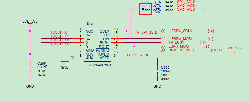

  • Hi Haibo,
    Could you show me the circuits around the tsc2046? How many units have you tried so far? Did you find any device that work normally? When this issue happens, will the device recover and work well again?
    Andy
  • Hi Andy,
    thanks for your quick reply!
    the circuits around tsc2046 are attacted.
    We tried at least four board, none can work normal. And once this issue happen(touch the screen once), the device can never recover again.
  • Haibo,
    Let me take a close look at the schematic and I will you let you if I find anything useful to you.
    Andy
  • Hi Haibo,
    I went through your schematic but I didn't find any obvious issue.

  • Hi Andy
    I try this, and yes, the PENIRQ pin and X+ pin all stay high when I do not touch the screen, and these two pins will stay low when I touch the screen and become high again when the finger is released.
    I also try add the community driver ads7846.c, and make some change in the function ads7846_irq, I remove the calling of ads7846_read_state(ts), and these two pins(PENIRQ and X+) return normal, just like the describe above.
    So I think this issue happens when we use SPI and send some commands to this tsc2046, after measure, seems this chip can't return to normal. But I check the code, the last command is Power-down(0x90), and according to the spec, this command can make the chip return to normal. So I'm confused on this point.
  • Hi Andy,
    Does the capacitance C266 necessary?
  • Hi Haibo,
    I think yes. On the TSC2046EVM, we put a 10uF cap.
    Andy

    the ads7846.c comes from linux-3.14 branch, and I compare the latest version in linux-4.0, seems no obvious change.
    and according to my recent debug, I find maybe our SPI operation cause this.
    I use the oscillosope, and get the SPI  clock, mosi, miso sigal.
    firstly, our spi work in DMA mode, and in linux driver, every time we sent a spi cmd, we will then recevie the date through miso, during the miso have valid data, the mosi also contain some cmd. we find that the cmd on mosi looks strange, every time spi send a cmd, for example, when we send the last cmd 0x90, actually, we can see three cmd were sent, they are 0x90, 0xc0, 0x92.  so the last cmd seems is 0x92, and this is not powerdown cmd,
    then we disable the dma mode in spi, and did the same test, when we send cmd 0x90, also three cmd sent out , they are 0x90, 0x00, 0x00. To tsc2046, all control cmd need to start with 1, so the real last cmd for tsc2046 is 0x90, then we find the status of X+ and PENIRQ return to normal.
    So currently, the X+ and PENIRQ return to normal if we set SPI work in cpu mode (disable DMA mode). But we find another issue, we find the coordinate value we get is not correct. Do you have any suggestion?

  • Hi Andy
    I think the reason of  incorrect coordinate value is cause by the SPI bus. I got the SPI bus wave. please refer to the attach file.

  • HI Andy
    our SPI clock is 1MHz.
    here I have some question:
    1, in default when SPI bus idle, MOSI and MISO shoud be in low level, but I see our SPI MOSI keeps high level .
    2. MISO should be low level if there is no data on it. But I see our SPI MISO change to high level when the busy single change to low from high.
    3, we find there alway a bit 0 at the end of the SPI command in MOSI during the busy single is high.
    we check out spi driver, we do not change do all the above, so I think maybe these phenomenon are tsc2046 chip related. Can you explain this? or Do you meet
    this issue before?
  • And I did a test, I remove the tsc2046 driver, and test the MOSI and MISO, they all keep low. This means our SPI keep these two line low when SPI bus idle.
    But once we use SPI send a command to tsc2046, we see the upper picture, MOSI change to HIGH from LOW when no command transfered on this line. And during the period between the command sent and the data all get, the MISO default change to high level rather than low level.
    So this time, I'm sure that tsc2046 make these changes. Can you explain why?
    according to the SPEC, figure 9, both MOSI and MISO keep low when bus idle. This is the difference!
  • Hi Haibo,
    Remove the pull-up resisters (R357 and R358) on the MOSI and MISO and try again.  The MOSI and MISO are pulled up to high by mistake, which could explain the incorrect waveform you captured.
    Andy
  • HI Andy
    we remove these two resistor, and the issue still exist. Seems that it is the tsc2046 pull up MOSI and MISO wrongly.
  • Hi Andy

    I think the Linux driver you are using now is quite OK.
    The screenshot below shows the SPI communication waveforms when the driver is running. My spi clock speed is about 760kHz.
    Andy

    The SPI MOSI and MOSI signal abnormal issue is already fixed, it is caused by our SPI host idle setting. Now the SPI wave is the same as SPEC, see below picture.
    But we find the position value is still incorrect. Do we need to delay some time before sample?

    If you think there might be something wrong with the LCD modules, I suggest you remove the touch screen panel and try a fixed resistor network below as the input to the TSC2046 in your system.
    You can see in the picture below, R1 : R4 = 1: 1 and R2 : R5 = 1: 1, so the expected output of tsc2046 should be very close to 2048, which is 4096 / 2 (See the trace log below). Likewise, if you change the ratio from 1:1 to something else (for example, 1:3), the coordinates should be around 1024 (4096 / 4).  In this way, it will be easier for you to debug your system since now you have a fixed input and output.

    The root cause has been found today. Our Hardware team make a stupid mistake. They misconnect the X-  and Y+. When I swap this two pin, the coordinate value return to normal.
    Sorry for distrub you such a long time.
