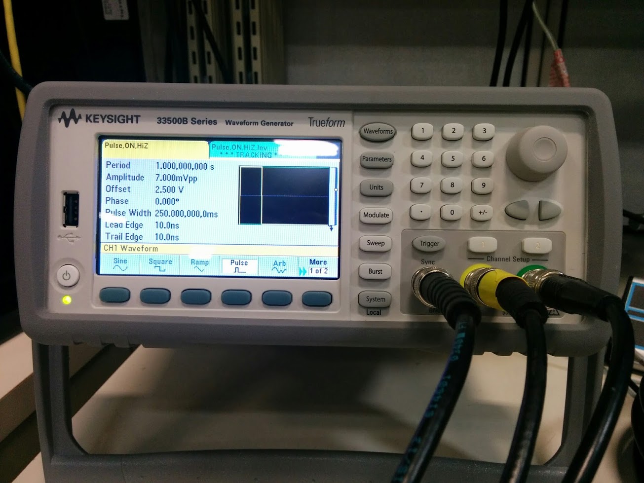

I was testing my circuit with sigma delta and comparing with an SAR architecture design. I am running both at a 20000 sps. So I was expecting a group delay of 38/20000 = 1.9mS for all the frequenciesin sigma delta. But as I started testing the variation in delay with the frequencies. I am getting strange results. At lower frequencies(10-100hz), I am getting the theoretical delay of 1.9mS and at higher frequencies (>500hz) I am not getting any delay. I still dont have the data between 100hz and 500hz. I will let you know as my testing progress. The group delay due to analog amplifiers and filters on both SAR and sigma delta is less than 100 micro second.
Test setup: waveform generator : 33500B series configured to differential signal output using two channels combined. Both devices connected in parallel.
In pulse testing, both sigma delta have lost 50mS of data, which is also unexpected.
What am I missing here? Is this phenomenon anyway related with sigma delta group delay/ settling time issue ?

  • ADS1178 is frame sync mode and SAR ADC is in SPI format. Yes I am comparing two ADCs SAR a legacy design we have and more or less the same amplifier parts. Only difference is SAR has 4 pole butterworth filter. But total group delays is in the around 100 microseconds from analog filters.
    In pulse testing, I lost the same amount of data on both SAR and sigma delta. You can see on slide 2. The input condition is shown in figure below
    period 1 Second
    pulse width 250 ms
    lead edge 10ns
    trail edge 10ns. Since I am missing on both, then there is something else.
    I will do 100hz to 500hz right now.
    Regarding /reset: In my knowledge No. I will double check. As far as I know, when it is triggered from micro, it should continue collecting data until it say stop. In the case of pulse, I took one second of data (only a portion is shown in slide 2) which is exactly one pulse (1 Second period).

    Are you sure that all of the graphs show the correct time scale? 250ms should include 5,000 points at 20kSPS. Most of the slides appear to have the correct time scale with the exception of slide 6. Slide 6 appears to show a 2kHz square wave since the period is only 0.5ms. Also, I do not expect the waveform to be so heavily filtered at such a high data rate.
    If there was an issue with the ADS1178 resetting, I would expect the output to go low (negative supply) instead of returning to -3.5mV. Why are the leading edges of the output pulses aligned? I would expect slide 3 to show the same group delay for both edges, similar to slide 2, for example.
