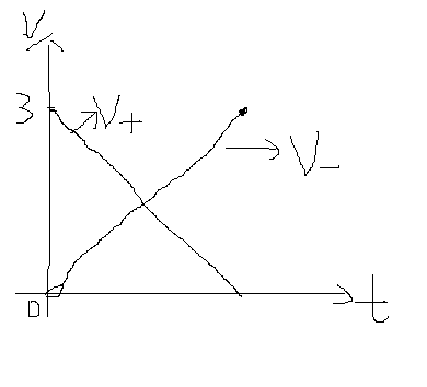

    I think i failed to discript my problem correctly.Actually ,I have  0V-3V signal on one channel,and 3V-0V on another,whithout minus voltage,so the differential voltage between the two signals is -3V to +3V,not 0V-6V,I'd like to show you the  curve
    At any time,the differential input is Vd=V+ - V-,from 3V to -3V.

  • Adam,
    Thank you for the clarification. Unfortunately, the link appears broken on the forum. Do you mind posting the picture again so I can see what you mean.
    Looking at the Electrical Characteristics table, the absolute input voltage minimum is AVSS-100mV and the minimum the AVSS power supply can be is -2.6V shown on page 4. So, You cannot have a -3V differential input or you will be violating specs.

    If it is,I would like to apply one signal ranging from 0V to 3V on AINP pin,and another signal ranging from 3V to 0V on AINN pin ,neither of  them  exceed the range of the absolute input voltage if the analog power supply is +5V.But the difference of the two pins would range from -3V (0V minus 3V) to +3V.(3V minus 0V).In ADS1258,the differential output(-3V to 3V) from MUX will be buffered to ADC input,is that OK?
    If you should fail to  see this link of picture again.I'd like to have you email  address and i'll sent it to you email box.Please look at the follwing  picture
    adam
  • Adam,
    Thank you for your picture and description. I did not fully understand what you were doing but I do now. You should not have any issue using the ADC in this configuration I have tested your setup on our EVM here to verify it works. I used a 5V power supply and a 5V reference and did not have any issues.
    Tony Calabria
