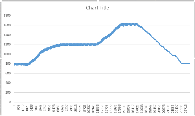

I am using ADS1296 to measure the DC output voltage from the Agilent U8002A single output DC power supply.
I have configured the ADS with the following,
Data rate :- 500 sps
Mode :- High Resolution mode
Gain :- 12
The input voltage was set to 80mV then it was slowly increased from 80mV till 160mV.
The measured values are then plotted in excel sheet. I was surprised with the plotted values.
I wanted to know why there is a fall in value, instead of the value stays constant?
Please comment.

  • Hello Brian Pisani,
    Thanks for your quick reply.  Sorry for the inconvenience caused.
    Here by I have attached the graph please refer the image,
    Also attached the circuit schematic for your referral,

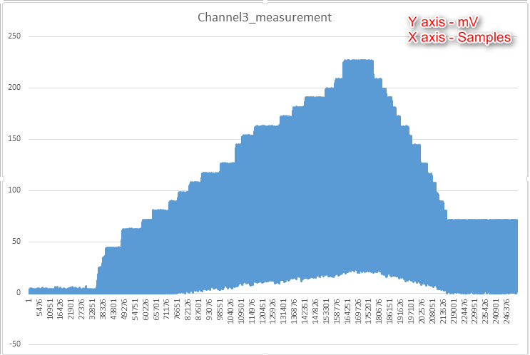

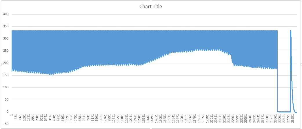

    So for I have not seen the Section 7.3 in page no 12. Analog inputs, the full scale differential input voltage range (AINp-AINn) is ±Vref / gain.
    Now, Vref in my case is 4V and gain is 12V. In that case, the maximum voltage can be measured by ADS is ±333mV.
    Am i correct? Correct me if I am wrong.
    Now I set the input variation from 0mV to 220mV. I could see the ADS measuring the same. Please find the below,
    Still, the output voltage is not staying constant. Take example at sample 43801 refer graph, i expect the output should stay at 48mV, but it swings between 48mV and zero hence we could see the full area is painted.
    As per my expectation, the graph should be like below,
    But the same behavior is not happening when the gain is 1. Can you find out where the problem could be?

  • Hey Nimi,
    You are correct that if Vref was 4 V and the gain was 12 that your effective input range would be +/-333 mV. A small detail is now you should be using the internal 2.4 V reference since the 4 V reference will not work with AVDD = 3.3V. In that case, your range should only be +/-200 mV, but I digress.
    That rule will determine the voltage that can exist between your positive and negative inputs, but there is another limit which will govern the range of your individual input voltages with respect to the power supplies. Take, for instance, this rather crude but hopefully illustrative example. Imagine you have a voltage of 100 mV which you are trying to measure with the ADS1296. Imagine that, with respect to AVSS, the positive voltage (AINP) is 10.1 V and the negative voltage (AINN) is 10 V. You can see that this AINP-AINN is a 100 mV and 100 mV should be under the differential measurement range for the device. However, it is outside of the supply rails and so connecting it to the inputs of the device would result in an incorrect voltage reading (and in this case you might also damage the device, but that is beside the point). Instead, if you'd like to measure 100 mV, you could instead make AINP = 2.1 V and AINN = 2 V. This will provide a correct reading since the absolute voltages are within the rails of the device. Equation 2 in the datasheet will provide you with the rule for determining correct input ranges by putting things in terms of Vcm, the common-mode input voltage. In the first scenario I proposed, Vcm = 10.05 V, which would violate the rule. In the second example, Vcm = 2.05 V, which is well within the boundary.
    Can you see the distinction I am making between differential input voltage range and common-mode input voltage range? Both requirements must be met in order to get a good conversion. In your case, I am wondering if your voltage source is actively maintained between the board supplies. I am under the impression that the differential voltage that you are trying to convert is "floating" with respect the board supplies and as a result Vcm with respect to AVSS cannot be guaranteed to be within the valid common-mode voltage range. Is this the case?
