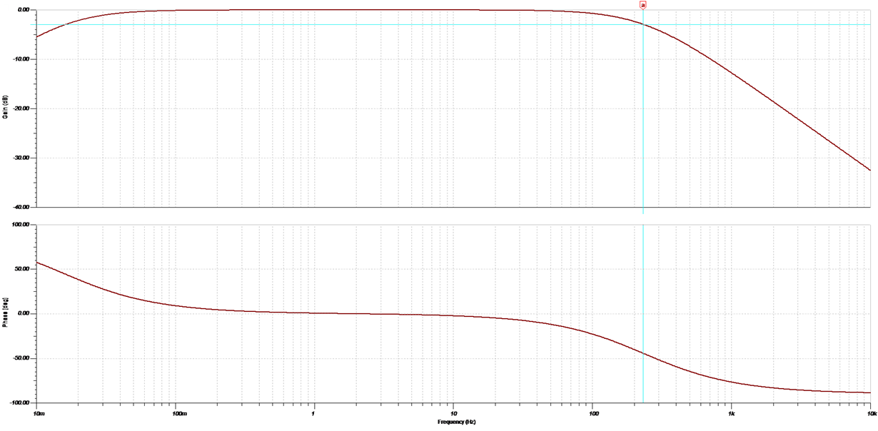

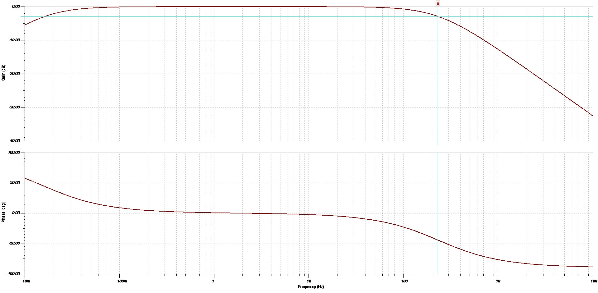

  • Hey Hector,
    According to my simulation, you'd actually see a cutoff frequency at around 232 Hz with the configuration in your schematic:

  • Sorry my image did not attach properly. It is attached to this post.
  • Hello Brain ;
    Thank you for your effort ; but I still could not understand why the simulation give a cutoff freq of 232 .
    for low pass filter R=10k+22k=32K ; C=1nF then cutoff freq=1/2*pi*32k*1nF=4973Hz
    for the high pass filer R=10M C= 1uf then cuttoff Freq = 0.016Hz
    Did I miss something in my calculation ?
    Thank you
  • Hey Hector,
    You have the capacitor C26 placed between the inputs as well which serves as another AC short.
    Brian Pisani
  • Yes Brain you are right I forget this capacitor ; because we think not to mount it if we mount it ; the capacitor will be 1nF and the others ( 100pF)

  • Hello Brain ;
    Here is the shematic ;
    ECG_P= 4.8V
    RLOUT= 2.4 V
    Thank you inadvanced 4064.ads1291.pdf
  • Hey Hector,
    I simulated with a couple of ideal current sources and measured the voltage that would appear at the inputs to the device. I did not simulate the diodes, but I imagine their contribution is only a few pF. When the current sources were set to 6nA and the electrodes were left open, a 13.5mVp waveform appeared at the inputs. When they were shorted (I shorted the wires, not sure how you guys are doing it), it produced a 511uVp waveform.
    I changed the current magnitude to 22uA. If the inputs are left open, the input would read above full scale. When they were shorted, a 1.76Vp input was received.
    I'm not sure how much you can trust this since it may not be an exact model to your setup, but I would expect numbers around this. By the way, I simulated using TINA-TI. It's handy in these sorts of scenarios: http://www.ti.com/tool/tina-ti
    Brian Pisani
