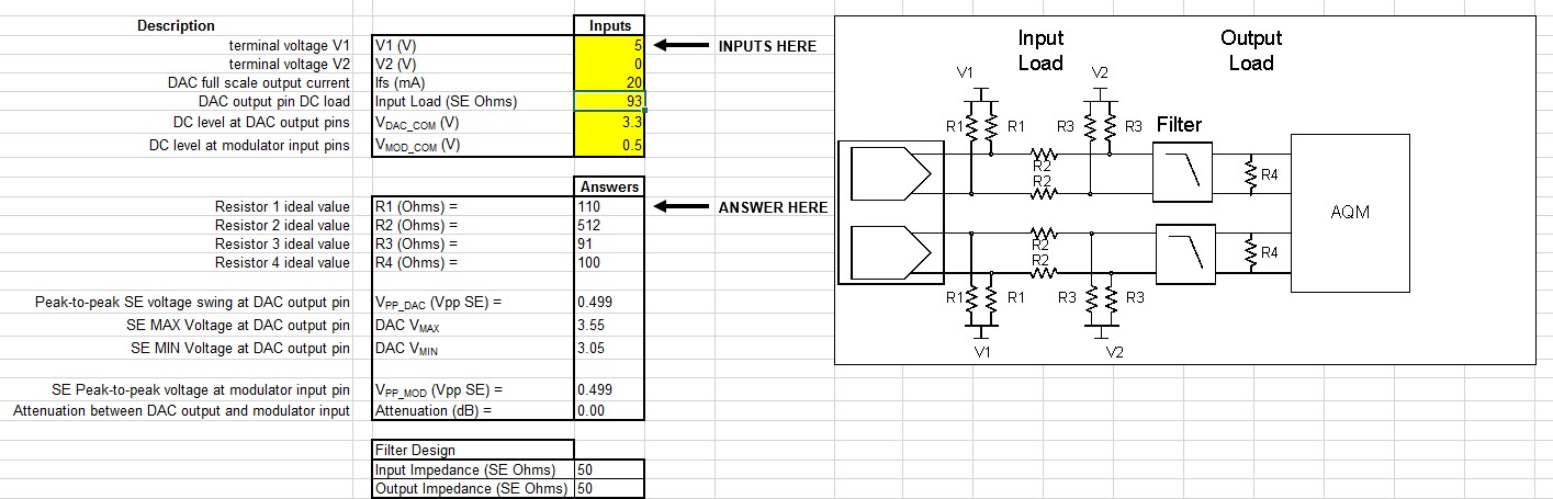

  • Hi Ken,
    Thanks for the feedback. I missed that the common mode voltage on the DAC had to be ~ 3.3V.
    Below is a screen shot with a common mode of 3.3V. I adjusted the DAC output pin load to achieve 100R diff impedance on the filter and modulator.
    Something that is not so clear to me, is the different tabs / names used on the spreadsheet: "unmatched impedance" / "Matched impedance" / "Matched Impedance pseudoDC". The latter is the image that I included and gives the voltages without attenuation.
    Any error in using it as such?
    J

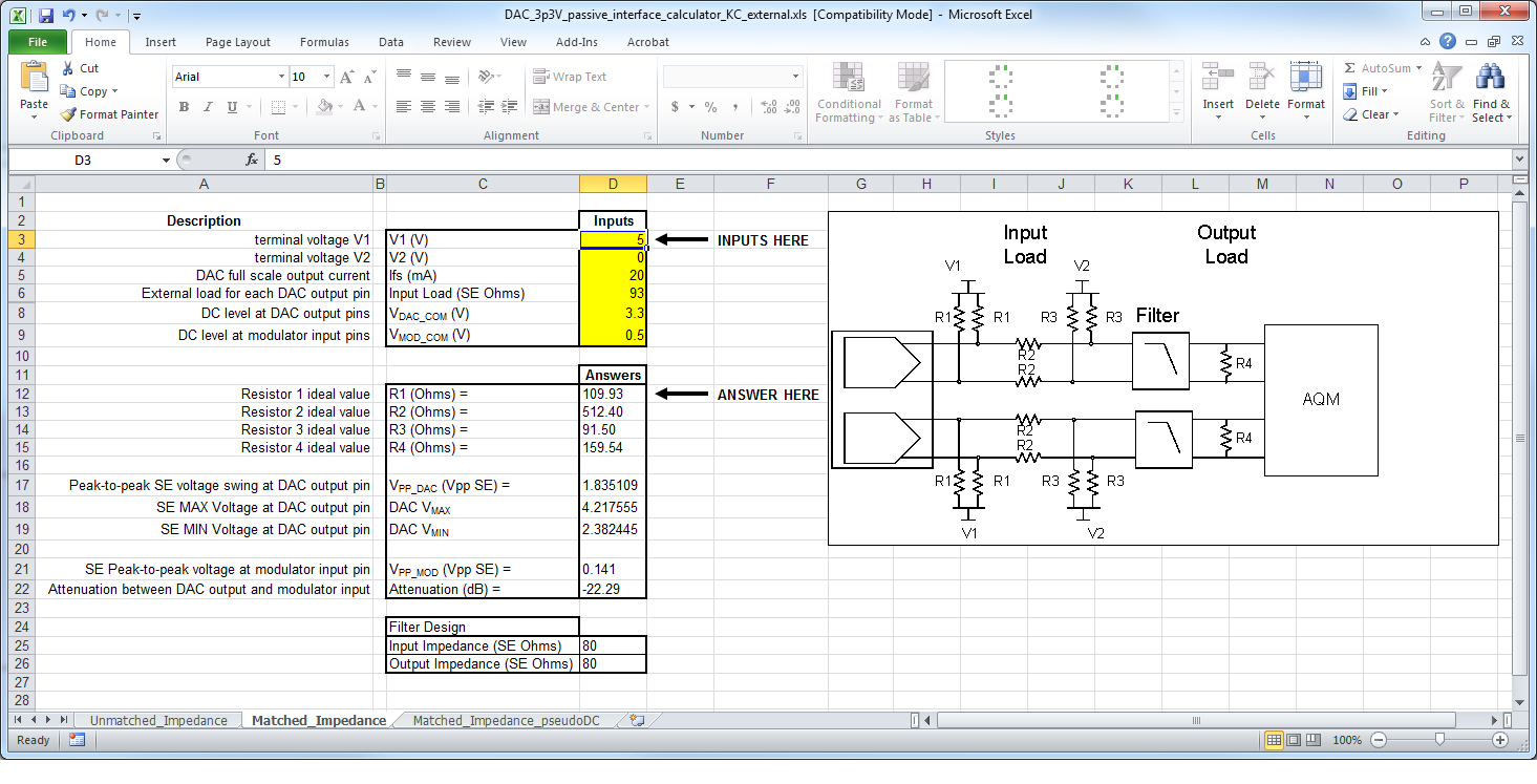

  • Johann,
    Typically we use the matched impedance version since it makes filter design easier as the filter sees the same impedance on in and output of the filter.
    Your xls look incorrect - I wonder if it is corrupted.  Just looking at the resistor drop from R2 to R3//(R4/2) already shows me that the attenuation cannot be 0.  Also the load on the DAC is too high and would exceed the compliance voltage of the DAC output/  Theres definitely something wrong with the xls you have.
    I used the same inputs on my calculator and it gave different results, but it does lineup with a simple TINA simulation showing the correct DC bias points - although it wuold still violate the compliance voltage as the DAC load is quite large and the 20mA will cause the swing to exceed the limits.  I have attached the xls I used.  Try it out.
    Ken.
    Your calculations:
    DAC_3p3V_passive_interface_calculator_KC_external.xls
  • Thanks Ken,
    The attenuation looked wrong, because the cap accross R2 was not shown (pseudo DC). Unfortunately we do use a DC output, so the
    AC short circuit will not help.
