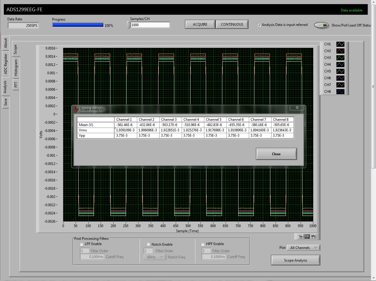

The test signal amplitude options are listed as +/- 1mv or +/- 2mV.  When configured for +/- 1mV the ADC produces a digital output of about 7000 counts peak to peak over time.  When configured for +/- 2mV the output is about 14000 peak to peak.  Are the output codes based on full scale of 4.5V VRef or 9V of -VRef to +VRef?

    Here is a raw data dump for about one second of time in the attached file.  Data was read in off the 1299.  I added the 0x00 after each 24 bits to make it easier to read.
    The range shown is about ff ee 70 to 00 09 af, so that should be to –4496 to +2497 = 6993.
    Based on 9V range I calculate 3.75mVp-p in the +/-1mV test configuration.

  • Hi Paul,
    Thanks for sharing the data. I also took some data on the bench using the ADS1299EVM and saw the same results that you observed. It looks like the typo actually exists on page 4 of the datasheet in the Electrical Characteristics table. The typical amplitudes are not +/-1mV or +/-2mV. This must be a copy/paste error from devices that use a typical reference voltage of 2.4 V.
    Instead, the test signal amplitude should read +/-1.875mV or +/-3.75mV. The equations on page 41 in the CONFIG2 register are correct. The User Guide section 5.3.1 (Figure 20) will also have to be updated.
    Here is a screen capture of my data (Gain = 1, CONFIG2[2] = 0):
    I'm sorry it took this long to realize the error.
